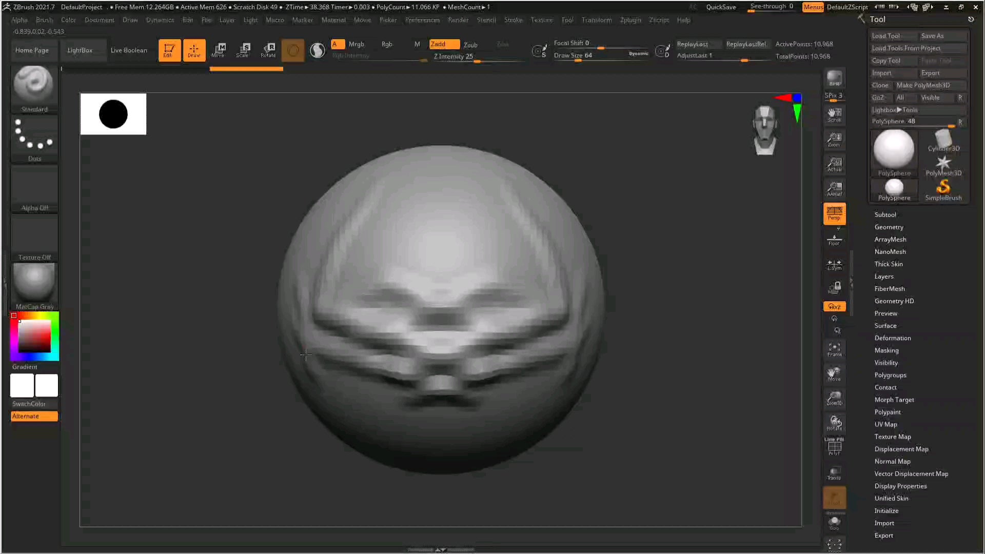

I recently installed zbrush on fedora and i am getting this wierd issue with my wacom tab that when i try to sculpt it scupt to other place to.
As i am new to this community it does not allow me to upload so i am sharing reddit post of my issue.
Hi @satyam_mishra. After checking your video I can recall seeing a similar issue myself, but that was really long ago (probably more than a year). It did not happen as frequent as for you, however I noticed while sculpting that suddenly the pointer would “jump” to another position and there will be a straight line from the initial position to the new point. This happened rarely, but in your case it seem to happen with every stroke.
The good news is that there is a solution. I do not have that issue at all.
The bad part is that first, I do not have any specific quide for how to get rid of the issue. As you wrote yourself the issue did not happen with Ubuntu. Neither does it (seem to) happen with Debian11. I think it happened with CentOS 7 (similar to Fedora) and I know it was possible to get rid of it, but sorry I do not remember what the cause or the solution could be.
If I ever could remember a solution I would share that, and unfortunately I can not find any notes about this issue. My advice is to play around with changing whatever you can think of and try to see if there is a change. You can especially adjust the window (for example full screen, not full screen etc). Good luck!
.@THINKIT , Thank you for the reply , I have tried many thing but it did not work. So I am currently using it in windows VM.
When you remember the solution pls tell as VM feels a lot slower.
@satyam_mishra Out of curiosity, when you are using the vm do you do a “passthrough” of your wacom tablet to it? If not, you probably should try it out.

@thinkit I got zbrush to work it was rather a simple solution. I had to manually adjust the zbrush window size to get rid of that jumping. As for the brush I edited the graphic>emulate virtual desktop in winecfg and now everything works fine.
Thank you for the suggestions.
So good you got a working configuration.
What I can see is that since you can configure so many aspects of a Linux system it is near impossible to say what will not work. For example, in this screenshot we see a dual screen setup over (Turbo) VNC where ZBrush is in full screen. A GoZ equivalent (Z) is working fine. The position mapping for both the stylus (nib) and the eraser (back of pen) is correct. For this I made a script that uses xsetwacom to map the wacom to either of the (local) screens and connected that to a keyboard hotkey.
In this setup I had to disable the “virtualtablet” mode (it will not work well in dual screen) and thus got the pressure mapping wrong (i.e. do not press too hard). In effect I just have to press half the amont to get the brush in full size. However I can accept that.
