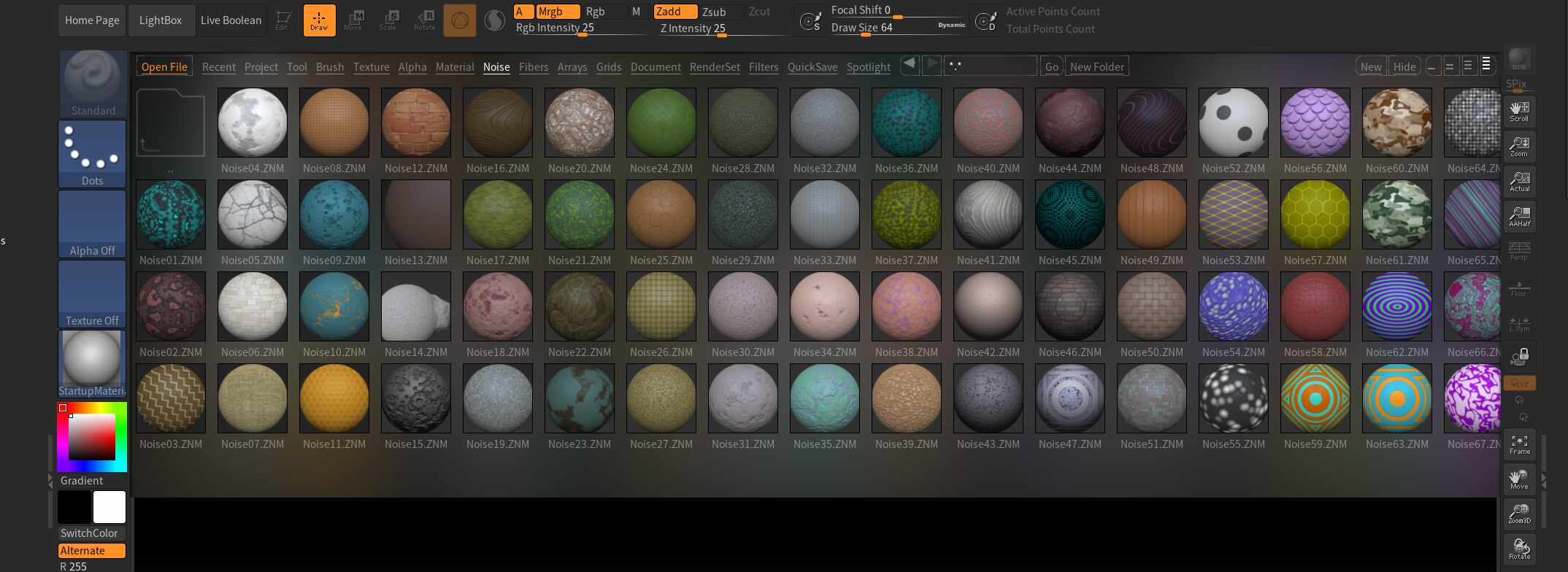

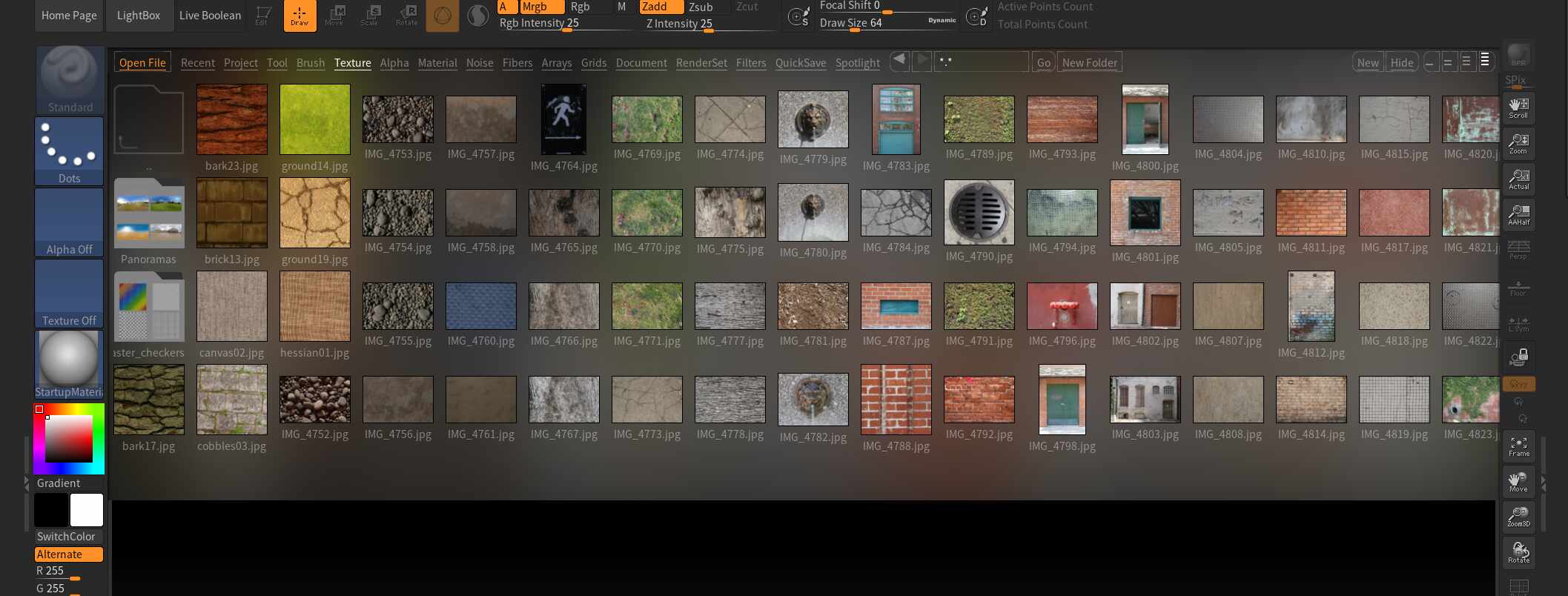

One way I figured to resolve some issues with Lightbox was to open up the folder in a File Explorer then to create a new folder from the File Explorer and place the files that I use/want in the new folder(s).

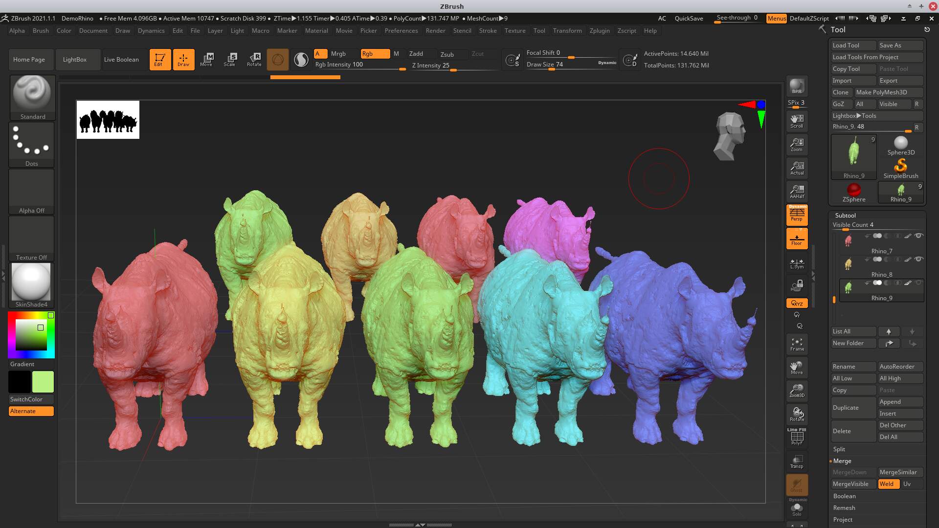

Performance has increased dramatically. Copying the subtools in the image was done quickly.
Issues are similar as mentioned previously, however all limitations have not been checked.
Basically use the Linux File Manager to work around the Lightbox icon limitation.
Use a mouse (not tablet) if you use ZBrush Wine file manager to avoid breaking tablet pressure support (unconfirmed).

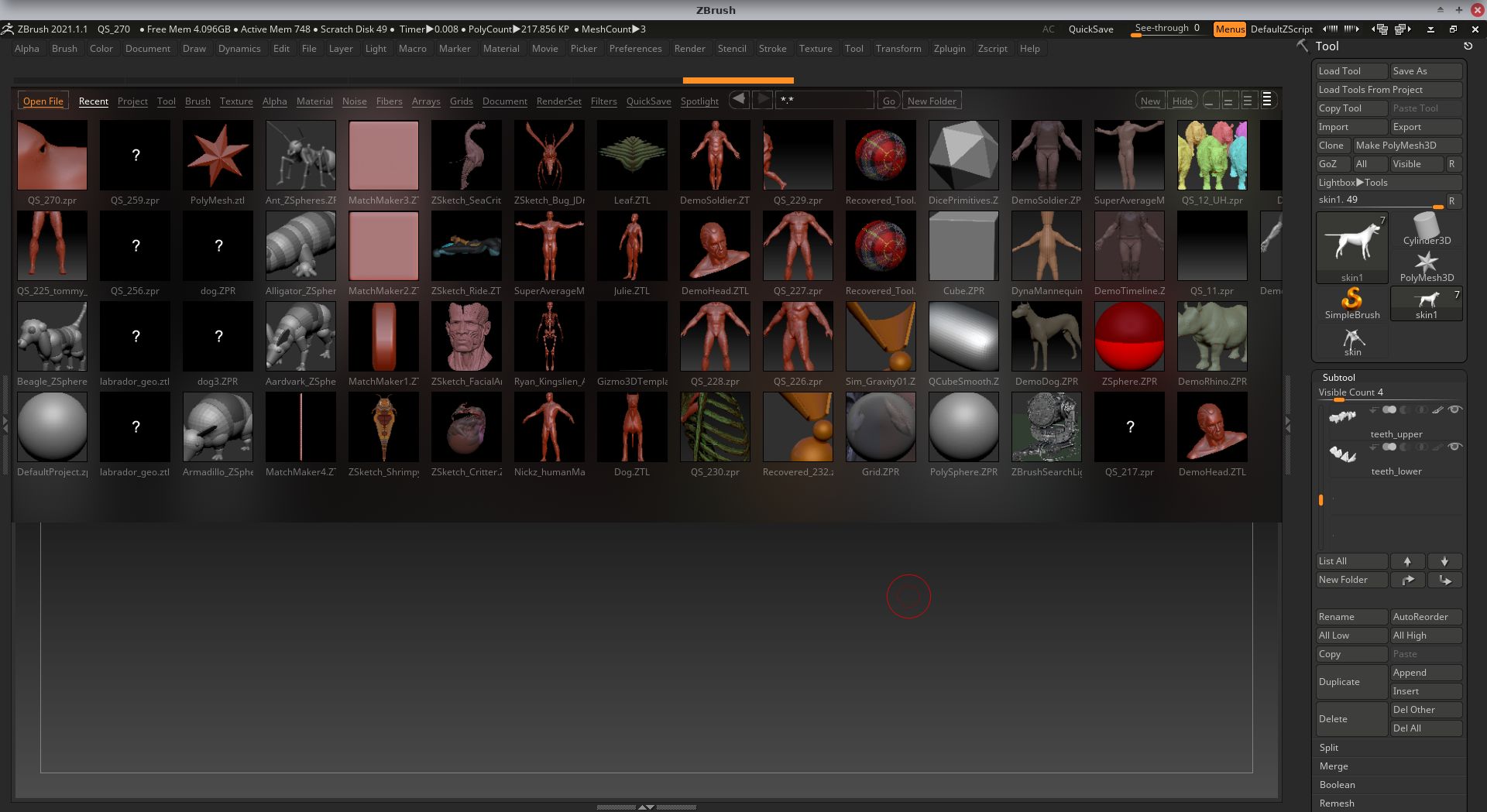

As for me I’m getting used to managing Wine Zbrush with the Linux File manager together with Z (tools). It is great.
As a supplement to using a Linux File Manager to interact with ZBrush it is now possible to have many shortcuts in Lightbox under the “Recent” tab (not other regular tabs).
Under Preferences / LightBox “Max Recent Files” can be set to 500. Using QuickSave and then moving those quicksaves with the Linux File Manager it is possible to more conveniently work with projects in combination with the “Recent” tab.

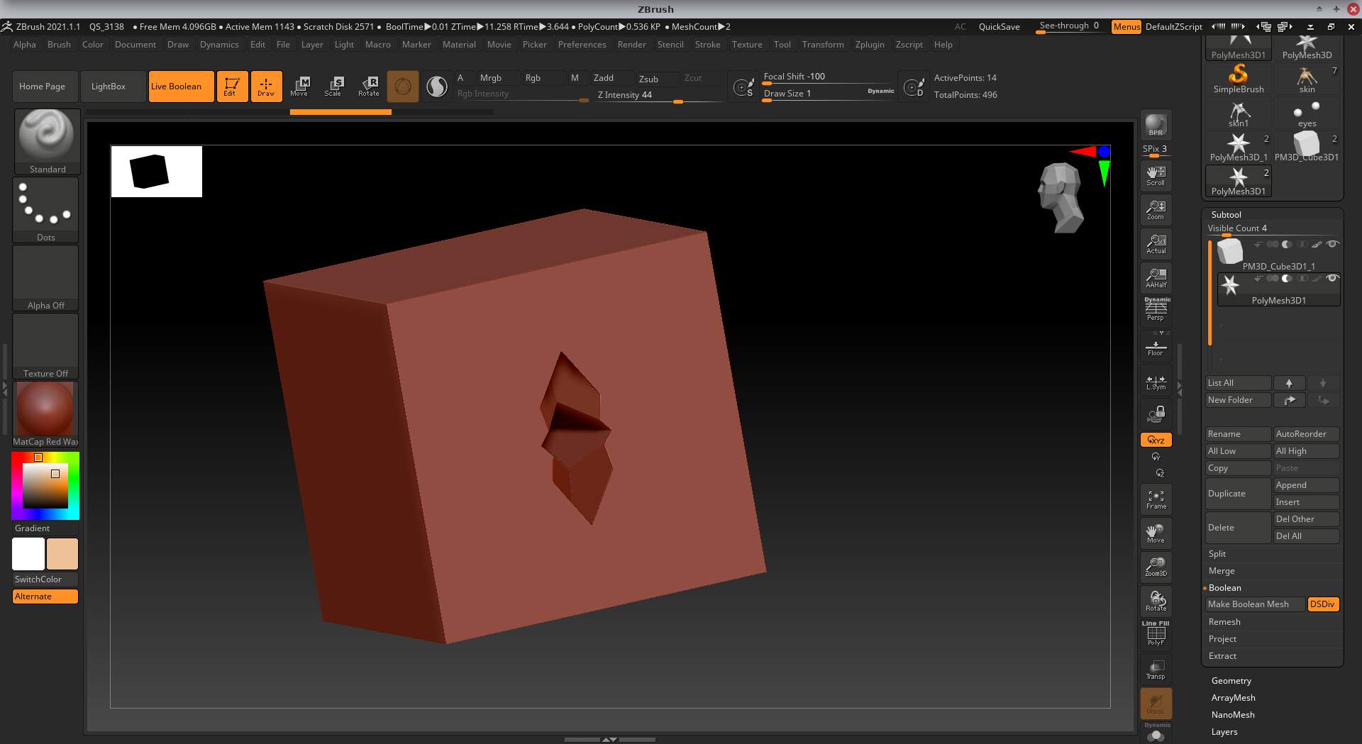

I have found that ZBrush2021.1.2 / “Liveboolean” and “Make boolean mesh” doesn’t work at all on my Ubuntu 20.04LTS, Lutris with Wine 5.5.
Anyone?
Here’s a subtract test with a cube and a star. It is also live, i.e. editable. It seems to work because it is possible to subdivide both inputs while retaining the subtraction. Does this not work?

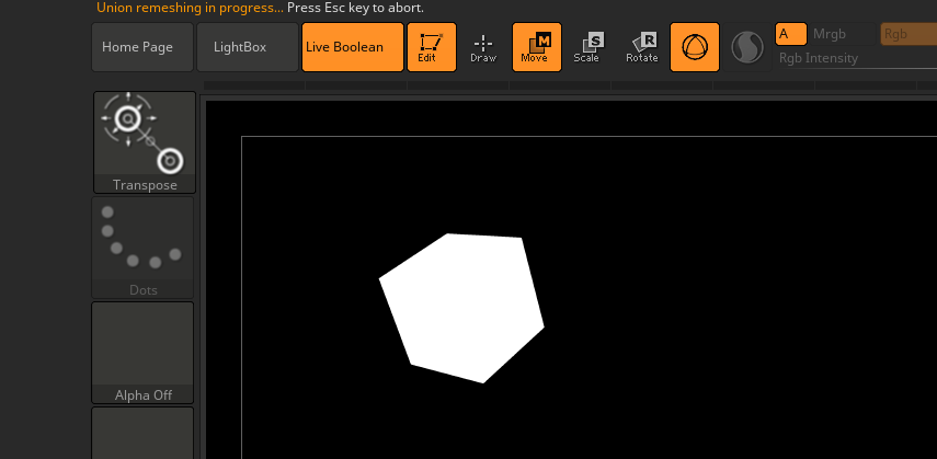

@thinkit, Thanks a lot for your report.
subdividing is ok, The issue is that a process always finishes without subtracted items, with this " Union remeshing in progress
" alert.
Screenshot from 2020-10-08 08-35-23
@Histone
The alert “Union remeshing in progress
” takes appx 10 seconds then it is done. It should disappear.
Troubleshooting suggestions:
  1. try a lowpoly mesh first
  2. check that you applied “Make PolyMesh3D”
  3. activate Live Boolean
  4. check your settings under Subtools (for example choose subtract)
  5. run “Make Boolean Mesh”
If the above does not work maybe there is something else hindering Boolean from working. On my system, for example, decimation only works for somewhat lower dense meshes. However I have a GoZ equivalent (Z) and can use Houdini also if needed.

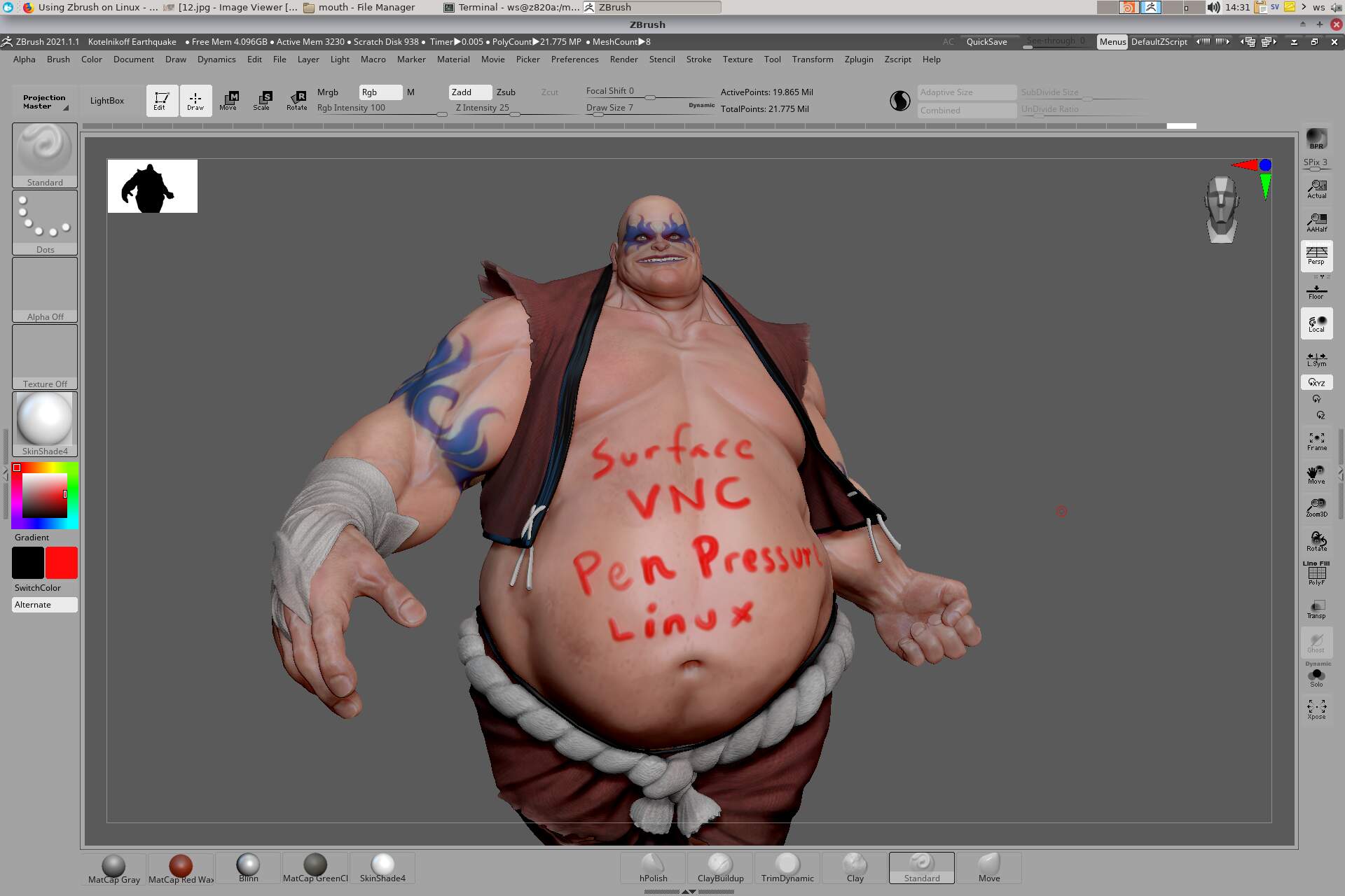

This post is simply related to Using Zbrush on Linux with a MS Surface Pro. Additionally it briefly describes how it is possible to use it to access a high-end workstation that run Zbrush. In my case it is Linux via Wine.
ZBrush on MS Surface Pro via VNC and Linux
For various reasons, for example having another day job, being a father, and travelling, has made me look for alternative ways to access my digital tools and workstation more flexibly.
If you just need a mobile solution and can not do technical trouble shooting with Linux you could simply buy a more high end laptop/Tablet and run ZBrush natively in Windows.
After successfully trying out the MS Surface Go 2 2-in-1 tablet/laptop using a Linux system on a USB-memory I was able to attain a cheap Surface Pro 2017. A dual boot system was installed with Windows 10 and Xubuntu (Ubuntu with XFCE).
Although it is possible to start high end software on a Surface Pro I am more interested in accessing my workstation with all its computing power such as CPU:s, GPU:s and storage. My Surface Pro is rather limited in performance when comparing with a workstation.
Using TurboVNC viewer on Xubuntu it is possible to access a TurboVNC server on a workstation. For that an SSH-tunnel was used with an identity file for RSA-encrypted data transfer through the local network. It also works via Internet with for example port forwarding. A great feature of TurboVNC server is that it can support pressure sensitivity for devices like Wacom or the Wintab driver in Wine.
As a side note, with the additional software VirtualGL it is also possible to run OpenGL software remotely. To access for example Nvidia drivers via VirtualGL an additional virtual display can be started (via Xorg).
Examples of benefits:
  • fast enough interaction and view updates with remote access through wireless network for the tablet (such as 5 GHz)
  • no noise work environment (for example the fans of a workstation)
  • a truly mobile access to a workstation (requires low latency internet connection with at least 25 Mbps)
  • battery support
  • touch screen support
  • pen with pressure support
  • A low end Surface Go or Surface Pro should be adequate for VNC
Not supported:
  • Sound through VNC (there exist other techniques that support remote sound access but it is not known if pen pressure is included.
Although this mobile work method can not compete with or replace a full desktop experience, it can provide another dimension of experiencing digital tools in a more casual context.

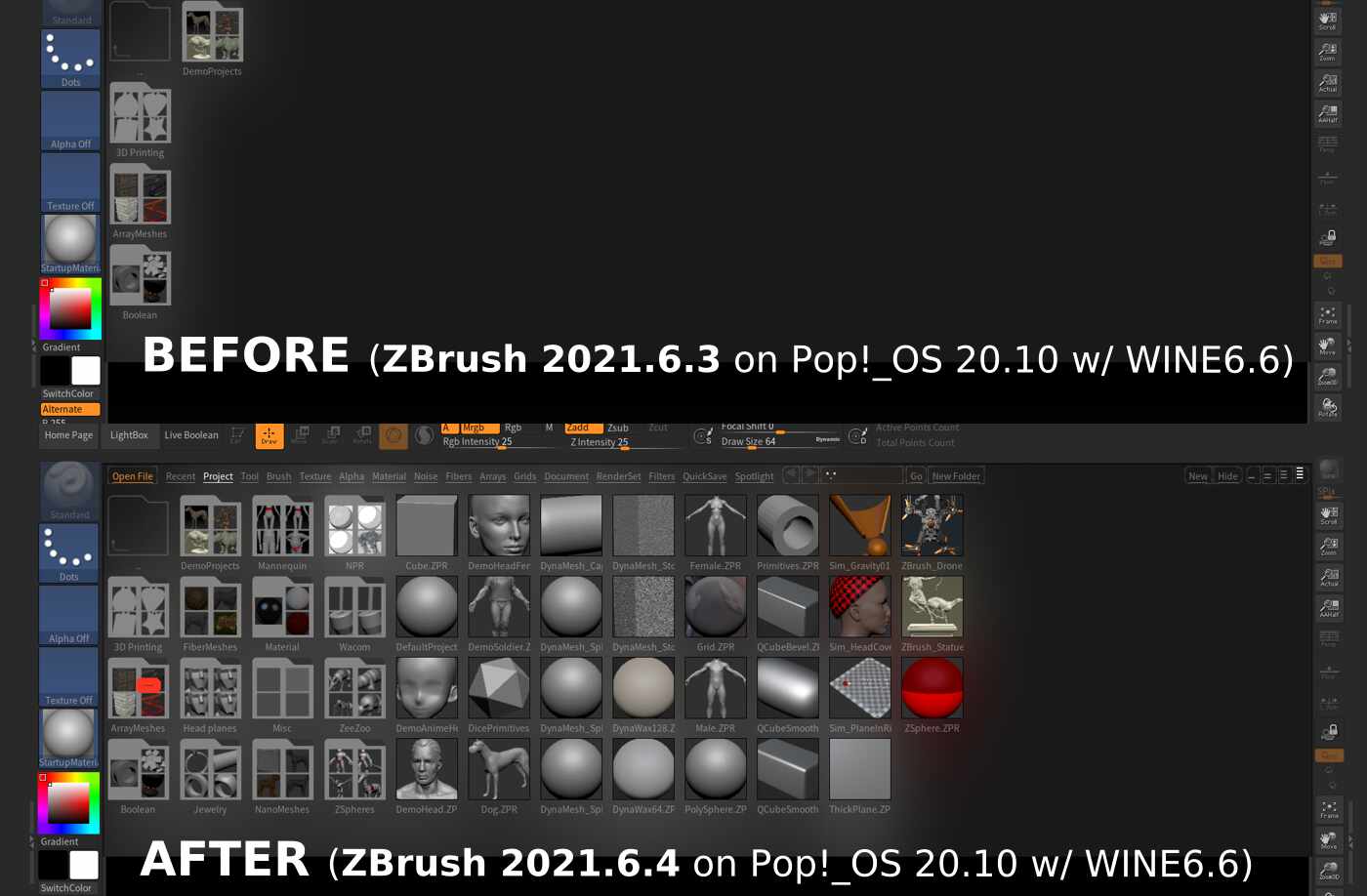

Hello, ZB on Linux enthusiasts.
ZBrush 2021.6.4 has been released and FINALLY, the lightbox issue has been solved.
now ZB runs PERFECTLY on Linux via WINE!
I got Windows version of ZBrush 2021.6.4 running on Pop!_OS 20.10 with wine 6.6.

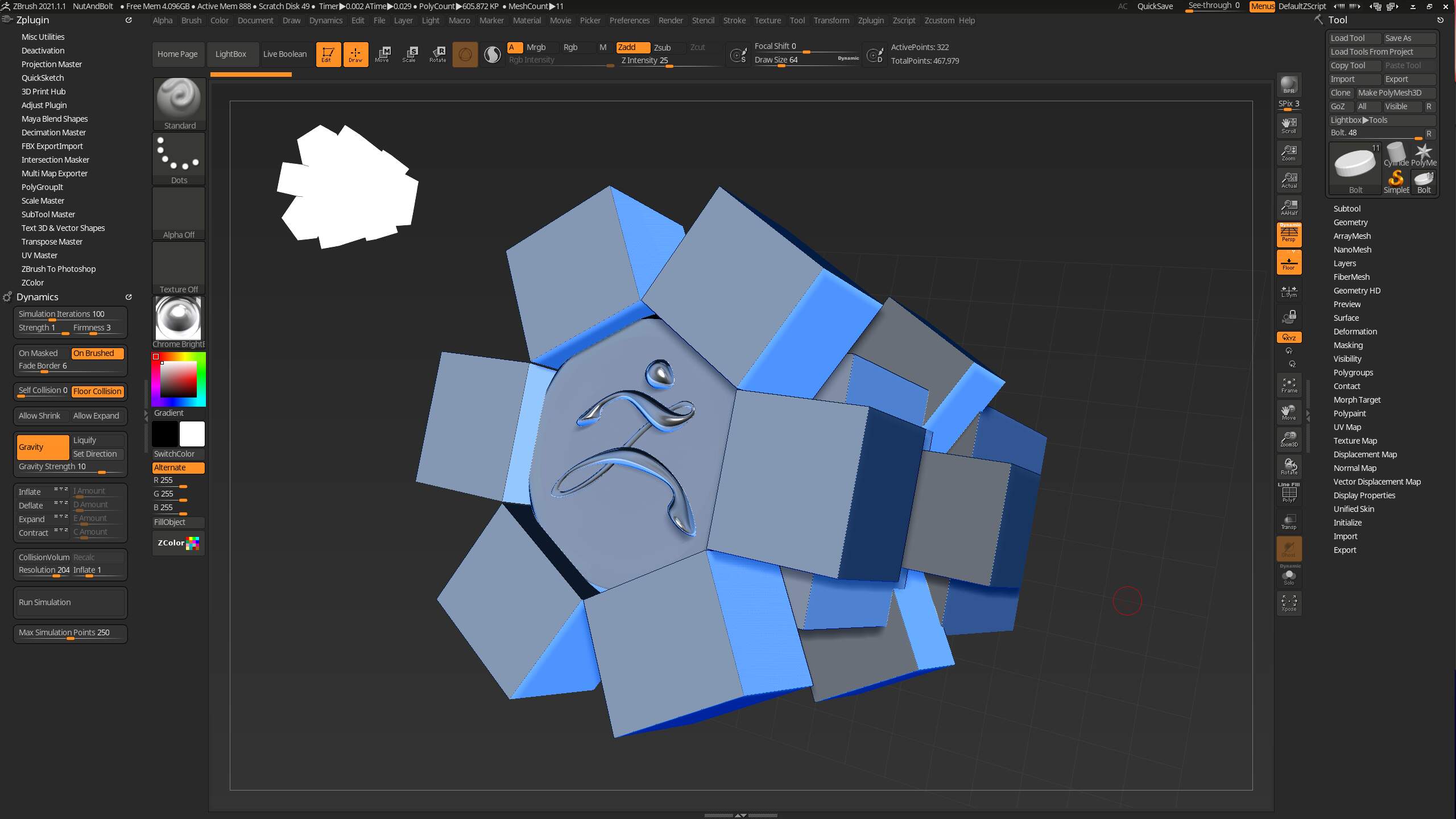

Does Decimation works for you?
