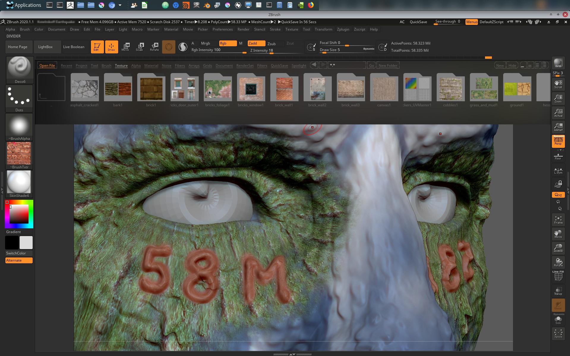

  • Did not get GoZ to work via Wine to (Linux) Houdini. Workaround: Simply import and export files.
  • When opening the external file browser from inside Wine Zbrush the Cintiq driver will exit silently so there is no pressure sensitivity any longer. Workaround: is to set up your project with assets early and then save your project. Restart Zbrush (appx 17 sec). Then use only the LightBox and Linux File Manager to access files during the session. Save the project development with QuickSave. When finished and ready to export assets and maps use the file browser as needed and then finally exit Zbrush.
  • LightBox seem to only show nine textures in each folder (however it shows many more folders with beautiful previews in LightBox) Workaround: Work project oriented and copy needed textures to a project folder using regular Linux File manager. If you copy textures you can just delete them when an asset is completed. Alternatively organize texture folders to hold at most nine textures in each (e.g. “bark1”, “bark2” etc). Also use symbolic links (links to folders with command “ln -s tofolder fromfolder” so fromfolder is just a link) so LightBox is faster and easier to use. For simplicity you could make a symbolic link for the entire ZBrush installation folder and reorganize it from there.
  • Additional work-around: You can open ZProject files or ZMaterials etc directly to ZBrush by doubleclicking in the Linux File Manager (this will bypass the Wine file manager when loading projects and thus not cause the Wacom pressure to fail).
  • ZRemesher will use appx. 393% CPU (12% of this system)
  • When closing WIne the entire system will be unresponsive for a few seconds.
  • There might be other limitations that are not known.
  • Hopefully as more users choose Linux with Wine the current limitations will be actually solved by some genious people.
My results: Strengths
  • In general I am impressed with how good it looks and how fast it is without lag (on my system there is no noticeable lag so that sculpting feels just like cutting in butter).
  • No need for a second workstation that has many implications such as reducing costs, saving space, energy, maintainance, screens, tablet/Cintiq etc, better security and more.
  • Switching between Linux programs and Wine with ZBrush feel almost like changing between any other apps (Wine with Zbrush is running like one app together).
  • Comparing with a previous test using a virtual Windows machine in Linux this Wine method is faster and integrate better with the Wacom Cintic/tablet and the file system.
  • Wacom/Cintiq works great (when aware of the file manager issue mentioned above)
  • For dual screen support with a single Cintiq I have my own script and keyboard shortcut with only the “Windows” key to change between screens (sorry no support for that).
  • Local folders are supported to share files between systems.

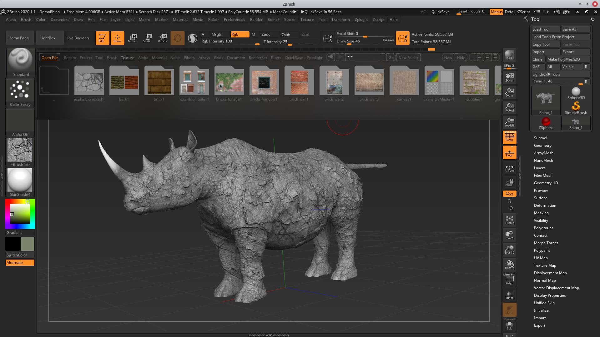

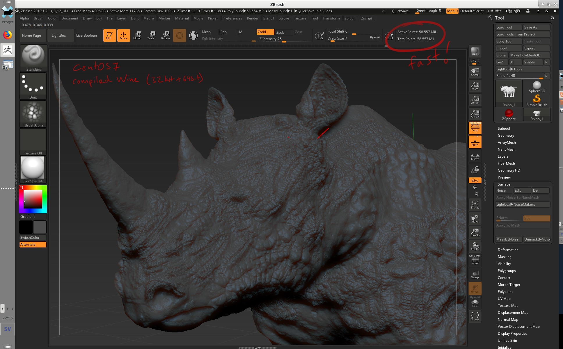

This post will be technical and is intended for anyone interested in such details. It is also only aimed at users who consider using a Linux only, or mostly Linux, pipeline. It is not intended for users who wish to learn how to use Linux, since such topics are best discussed elsewhere (see my above post). The testing is not done in depth or in an exact manner, but rather quite fast and rough. It should anyway provide a hint of what you could expect.
Case
  • The guidelines as described above were used.
  • running ZBrush under Wine with a data intensive asset (see attachement).
less /proc/cpuinfo (extracts from CPU-info)
processor       : 0
model name      : Intel(R) Xeon(R) CPU E5-2687W 0 @ 3.10GHz
cpu MHz         : 1651.037
cache size      : 20480 KB
siblings        : 16
cpu cores       : 8
processor       : 1
(same as above)
free (a memory app)
total        used        free      shared  buff/cache   available
Mem:           82G         13G        1.5G        900M         67G         67G
Swap:           15G         37M         15G
top (a processes app)
PID USER      PR  NI    VIRT    RES    SHR S  %CPU %MEM     TIME+ COMMAND
32495 user       20   0   10.2g   7.1g  19400 S  17.2  8.6  63:38.69 ZBrush.exe
32456 user       20   0   24800  13100    820 S   6.9  0.0   3:53.43 wineserver
Observed results
  • At 58M points it is very responsive when subdividing the asset, performing sculpting and polypainting with textures, and finally doing a QuickSave.
  • Leaving ZBrush unattended with such a heavy asset and changing app requires appx 10 sec to gain responsiveness when returning (this is not the case with less data intensive assets).
  • A QuickSave of this file takes about 10 sec on a fast permanent storage (RAID10, quad SSD)
  • For 58M points filling the view and tumbling the camera on a standard FullHD display it causes ZBrush to redraw a lot. Then ZBrush.exe under Wine use at most appx 69% of the total CPU-power.
  • To compare, a document window that has 900x900px will use 56% CPU-power.
Discussion
In the past I’ve used Zbrush both on decent Windows and Mac systems, but never have seen this overall performance. That includes reading and saving files with 50M points. Switching between apps. The point is, if you can handle the workarounds for using ZBrush under Wine and you do not need other Windows or Mac compatible software, then this method might be an option. First you should test it according to your needs before committing.

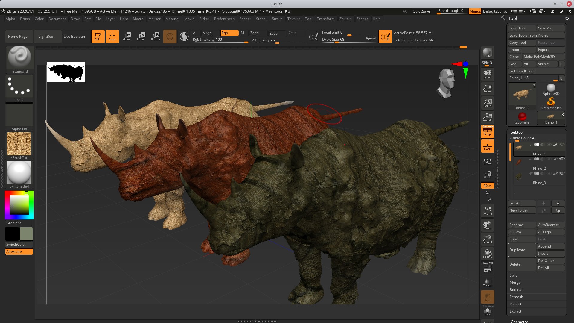

@Przemas
Nice video. It could help people who prefer clicking and not typing commands, however I prefer the commands.
The current limitations and some workarounds to ZBrush Wine LightBox are described in my post above (under “Known limitations”).
“Free Mem” always show 4.096 GB so that value does not read and show properly. Active Mem and Scratch Disk seem to work.
I did a test with three Rhinos at 58M each. That ended up with three subtools with a total of 175 M points. When editing these Active Mem goes up to appx 27 G.
To work with 175M points QuickSave should be set to a very high “Durations” value and Skip History enabled. Otherwise such a file can take 10 minutes to save.
Also, I see that the Scratch Disk is increasingly used by ZBrush so that storage should be as fast as possible (knowing a lot about Linux systems could be beneficial).

I can’t recall or recreate any screen tearing while rotating or moving. However I can see some if I resize the Window. Make sure you do not have a “move window” shortcut added to your “alt” key or some other hotkey that you use.
You did not mention any trouble with “wacom pressure” being disabled after opening the file manager inside ZBrush Wine. Don’t you have that issue?
I can notice that ZSphere models like Cat_ZSpheres has a lower framerate than any PolyMesh3D. So with ZSpheres there is some screen tearing while rotating fast. This can be improved (at least on my installation). Please try Preferences > Performance > MultiDraw: disable. However, for PolyMesh3D multidraw should be enabled.
sadly I’m seeing the pressure issue after using file dialog as well. This one is a bit weird as I don’t think I’ve seen it in the past (one of the older versions of Zbrush + older Gnome). Not 100% sure though as at that time running Zbrush under Linux has been something I did just to check whether it is doable.
The tearing is quite noticeable on my system. But I see you’re using Xfce, while I’m on Gnome, so I’ll try different desktop environment (probably KDE).
Multidraw: disable brings fps so much down that it is basically unworkable on my end.

This keeps getting better. Here’s now 234 M TotalPoints fairly manageable if needed. Yes sculpting Meanwhile another ZBrush is running at the same time. I noticed that ZSketch ZSpheres (as seen in the image) both look better and does not have any lag or tearing whatsoever. There is no need to change any settings for them.

If it is any help my Wine version is:
[user@z820 ~]$ wine --version
wine-4.21
[user@z820 ~]$ wine64 --version
wine-4.21
