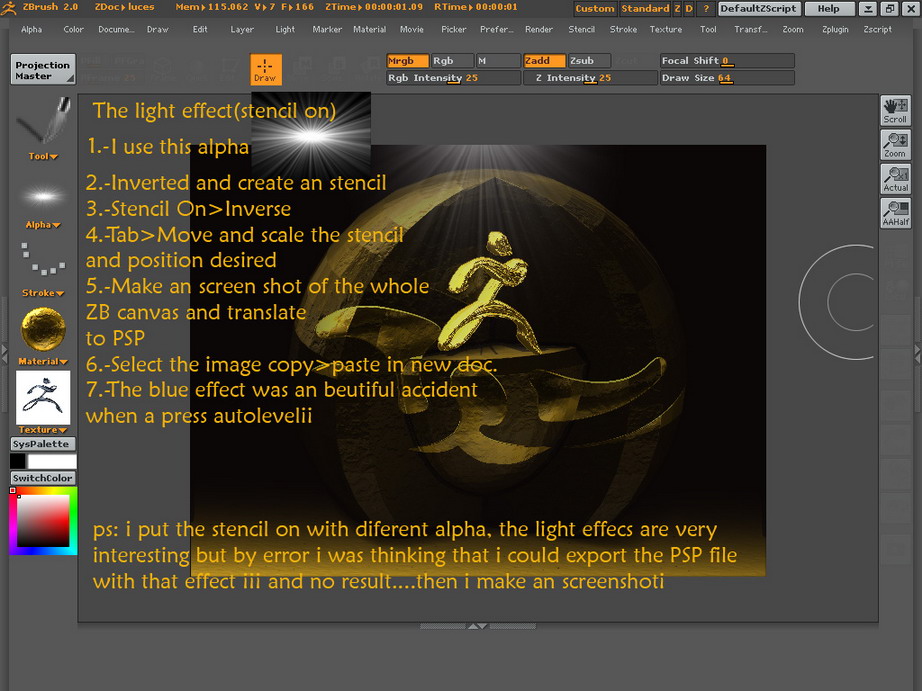

The light effect was working with stencil…¡¡
here is an explanation and the alpha that was used.
this alpha is from Pinnacle software.
Hope this help¡ please feel free to ask if not clear.

I will post some light exercise with this approach¡¡
I was not sure to post but your comment and also Marcel stimulated me to post in this line.
The alpha and stencil give tons of doors to open¡¡
Will be very nice if ZB code could allow to use the light spectrum effect that you can create with the stencil tool…is a of wish list to the update¡
