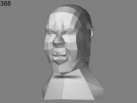

The purpose is to show an easy way(just one of many ways) to get some details without reaching a million poly
1.-The gift show the very low poly from zsphere (level 1) up to level 5:only 94208 polygons
2.-The zscript recorded session where is the overall process, the script will tell you to:
a.-export the mesh
b.save the tool
c.Import the mesh again: when ask this in the zip is there the file zsphereheadmodel, pic up this.
d.After tell you to export images, i put the numerb1 to 5 (the levels i used) to make the gift animation.
Hope this help
