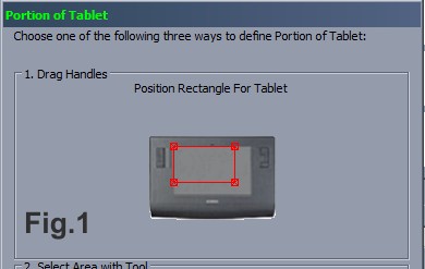

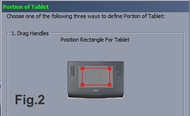

Why don’t you use the drag handles to define the tablet portion. It doesn’t have to be that precise. The Intuos3 medium is 3/4 the size of the Intuos4 large. You can eyeball 3/4 size with the corner drag handles (Fig.1) then just grab the rectangle in the middle and center it (Fig,.2)
i don’t think you understand it has to be proportional equivalent as to what aspect ratio your screen is …there for if its off ti makes accuracy near to impossible i really don’t understand why you would eyeball it … especially when the active area has to match proportions of the screen your working on you eyeball it could throw everything of and in turn screw up the way your hand makes shapes…
i guess you dont know what im trying to say because you have never delt with this before…:confused:
