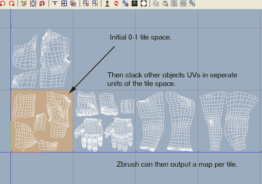

Yes an eye and a face yea thats fine. I work with models that have multiple objects all the time. You can arrange your UVs in maya in such a way that

Yes you can have (**output from Zbrush) a map for each seperate object or several maps
per object. Its all based on how you layout your UVs.
For the head and eye thing you can import an obj file the includes a head
and two seperate eyes. Draw the mesh into the canvas then goto
Tool - Polygroups -Auto Groups . That will give you a group per object.

Dave - thanks a million for the screencap of uv seperation using different tile spaces. That’s the best explination I’ve seen yet ! Always suspected that was what everyone meant by seperating uv coordinates and now I understand fully. Looks like Maya allows you to display multiple UV maps at the same time ? Each of the tiles contains a seperate UV set - LW allows only one UV map selection and display at a time as far as I know so in my case I’d just have to keep track of which map goes in which tile.
Another semi related topic - any luck with generating multiple maps off a single mesh and dealing with the different greyscale value ranges (non floating point map problem) ? I’m assuming the multi displacement map generating plugin treats each uv set as a completely seperate operation and still gives inconsistent values from map to map (even if on a single mesh) ?

I created my UVS in 4 different tiles in 0-1 space inside maya, just like the image you posted in this thread. When I import this model into Zbrush and click on UNCheck (under the texture tab), my entire model looks red(indicating overlapp of UVS). However when I click UVgroups , I see that my model has been divided into individual groups correctly. I guess my question is that why is my model showing up all in red when I do UV check ???How to fix this.
thanks a lot.
For the purposes of texturing, normal map creation and standard displacement map creation you can only have one UV region/tile (0,0 to 1,1). All other UV regions are overlaid the first UV region. It is natural that a UV check will show many areas with red.
With the Zplugin > Multi Displacement plugin you can utilise the extra UV regions to create multiple displacement maps. So in other words, ZBrush does register the multiple UV regions but can not currently (ZBbrush 2) utilise them for anything but assigning Polygroups and creating multiple displacement maps .
Of course when you press Tool > Polygroups > UV Groups you can quickly select which part of the geometry, and hence, which UV region you want to work on. So you can work with multiple textures that way, but you will not be able to view them all at once.

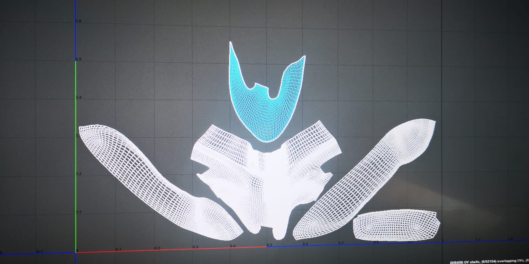

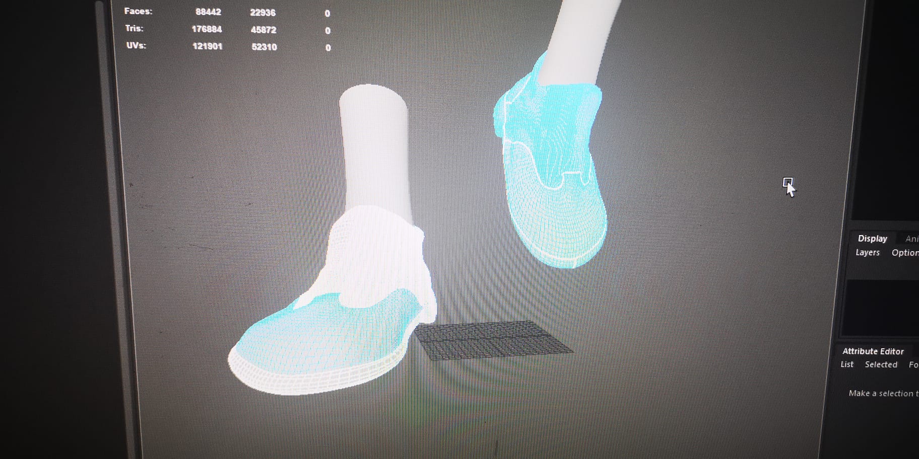

After almost 20 years, I have some similar problem.
Some cuts appears inside the shape of my UV’s when i export from Z.
I have tried export as obj (mrg on, grp on, just one of them, none of them) and as fbx too.
It’s the same subtool and the same polygroup.
I have not an explanation for this :frowning:
