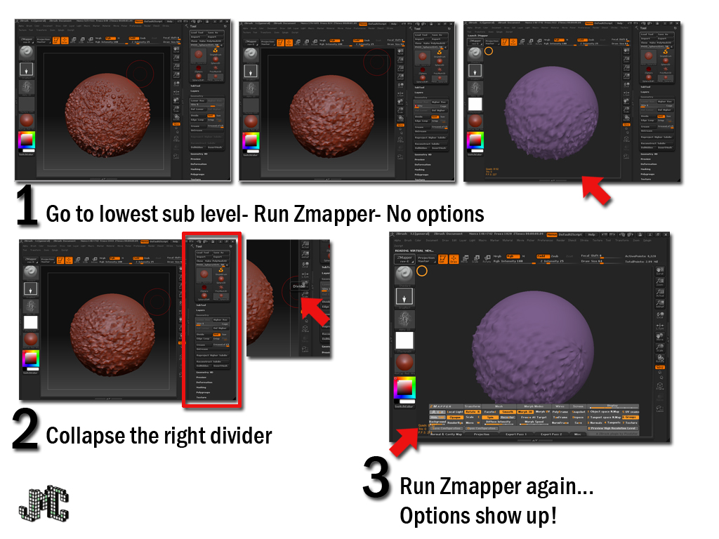

Hi all. Im looking at generating some normal maps with z-mapper, but when I click on the z-mapper button, the model turns blueish and starts turning on its axis, as it should do yeah? but thats all. Im not getting the menu with all the different settings and options. I read that you can press the tab key to toggle the menu on and off but this does nothing for me. Do you have to wait for a while as zbrush works some things out?
Which ZBrush version are you using?
I am using 3.1
I had that same problem a while ago on 3.1, I believe it has something to do with the screen resolution… Anyway, just collapse the right divider and your zmapper options should pop up at the bottom…
problem solved. Cheers jmc.
