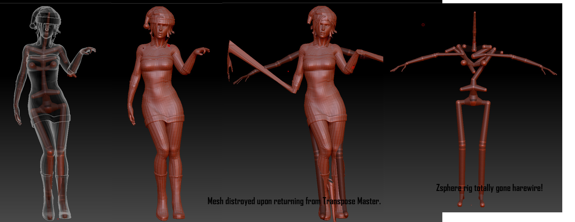

I used Zbrush 4R6 Transpose master with Zsphere Rig.
Hello, as seen in the attached picture. Every thing is fine until I press TPose>SubT. The arms are completely destroyed. Also the Zsphere gone hare-wire, with the zip zapping in the torso & arms’ areas. Anyone know why, & is there a solution.

Is your model very large? Usually this type of error occurs with large models.
Yes. Its large by Zbrush standard, but in reality its real life scale. She is about 170cm tall (in Maya at least) with the boots. I have to scale the brush to o sculpting.
The zsphere get harewire I think during unbinding mesh.
You’ll have to scale your model down if you want to pose with a zsphere rig.
So its a design issue with large models. Damn. Doesn’t make sense when I m using real world scale. Oh well.

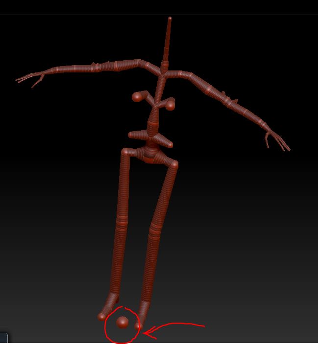

Not wanting to create a new thread, but how do you delete an extra isolated zsphere?
While in Add mode, click the sphere while holding alt. I was on the iPad at the time and couldn’t confirm. No problems posting with IE or Safari.
Set your brush draw size to 1. Then alt click on the sphere, it should delete it. By the way I think it’s recommended to use a draw size of 1 when building Zspheres, but I could be wrong.

Anyway, thanks everyone for the reply to my question on the ZSphere. I can’t use the ALt-click method as it is some sort of parent. I cannot move the sphere as well! I have reason to believe it may be the cause (or one of the cause) of the corrupted meshes.
For some reason, the outermost meshes are pulled to the left & right imaginary corners & flatten, also, the top meshes are being pulled to the bottom when the Lonely sphere is located.

Anyway, I remake the zsphere (almost) & while an improvement (unbind doesn’t make the zsphere entangled now), the same exploded mesh happen. I have to use very dirty & slow methods to extract out the meshes.

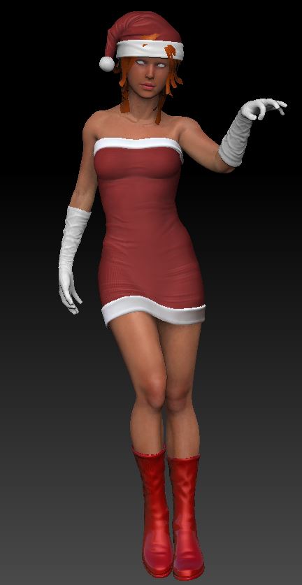

Nevertheless, this is the result, after patching the meshes, & addtional pose using purely tranpsot master (without buggy Rigging tools). Just using Transport master without rigging is SO SO SO much problem free!

Edit: manage to continue work on her, after the drama, did a bit of texturing, & update her pose. Going well. Now the work in Zbrush is done, back to maya for rendering now.
