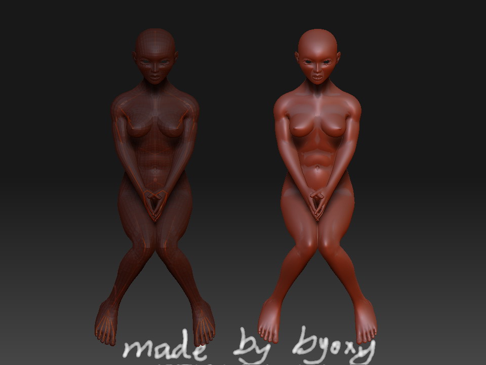

I made it by reference your tutorial,it is so amazing and impressive,thanks Rastman!:smiley:
