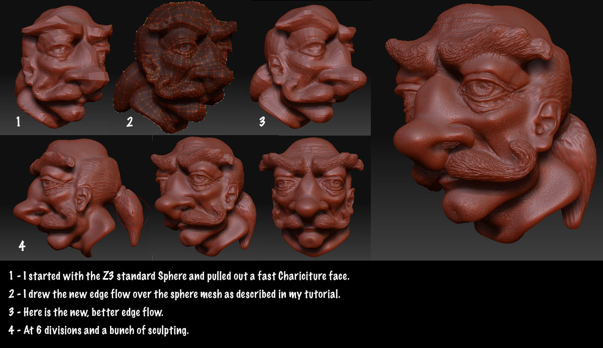

sorry that in the moment I have not much time to take part in this thread, but I just finished a tutorial about the ZProject-Brush and will now go back to one of Plakkies original intentions in this thread, creating a nearly good topology over a zsphere-base-model. :smiley:

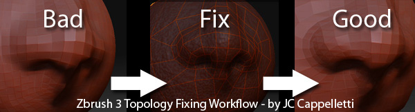

I was invited by Plakkie to post this tutorial on this thread, so here it is.
My students have been asking me to write a tutorial for the re-topologize feature in zbrush 3. Most have had a hard time following the tutorial on the Pixologic site. I came up with a step-by-step that most people will easily be able to follow. I thought I would share it with all of you.
By the way, the big arrows are meant to make everything very clear because there are some steps in this process where it is easy to mess things up. I don’t mean to talk down to anyone. This was designed for beginners, but I’m sure some advanced users will find it useful.
Here is the link:
http://jcappelletti.freehostia.com/z3tut01/
  • JC Cappelletti
Thanks JC! :+1:
Thanks jcappelletti for that nice and clear tutorial, that’s the way I like it! :+1: :+1:

One short update about topo-rigging:
Marcus_Civis posted in my tutorial-thread an easy way of posing low-subd-level-models with topo-rigging and then simply change it later in a high-subd-level for rendering.
Follow the first link in my signature for this and go to site 3 or read the top-post.
Thanks again to Marcus.:+1:
