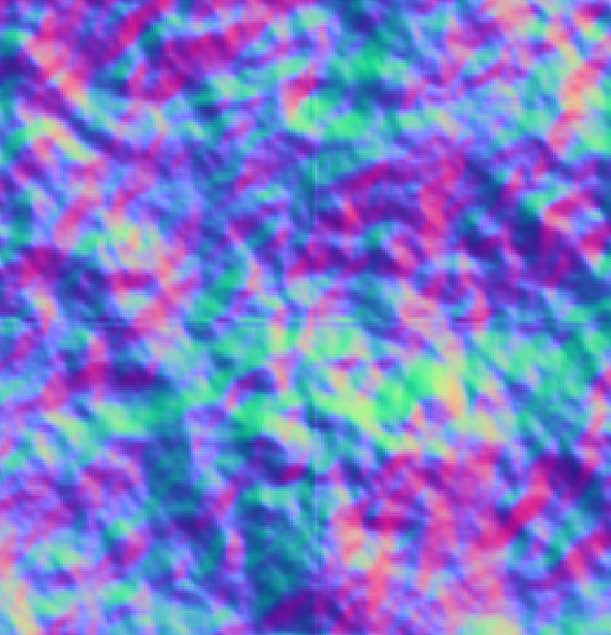

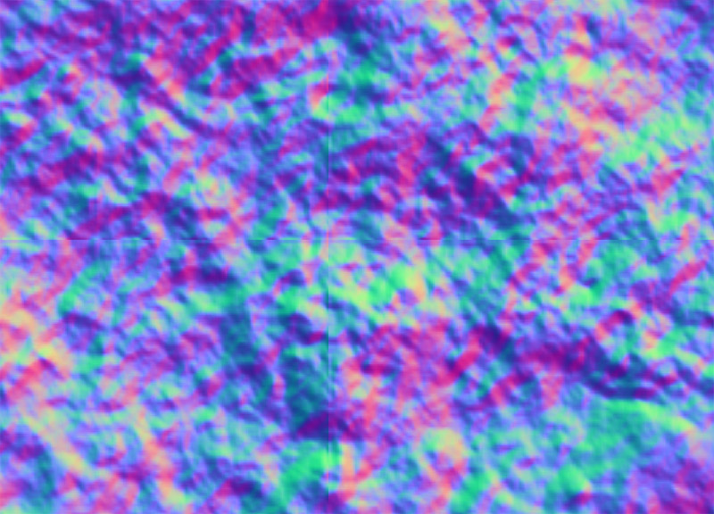

This is the normal map offset to see the seam. it’s a best render and zapplinked.
When using the ~ key in ZBrush to check the tiling then you should not see any seams. If you are, then it is most likely a fault with the displacement image.

here’s a screen using tilda

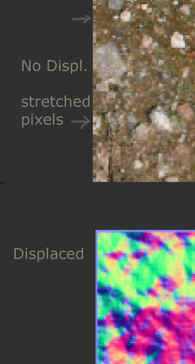

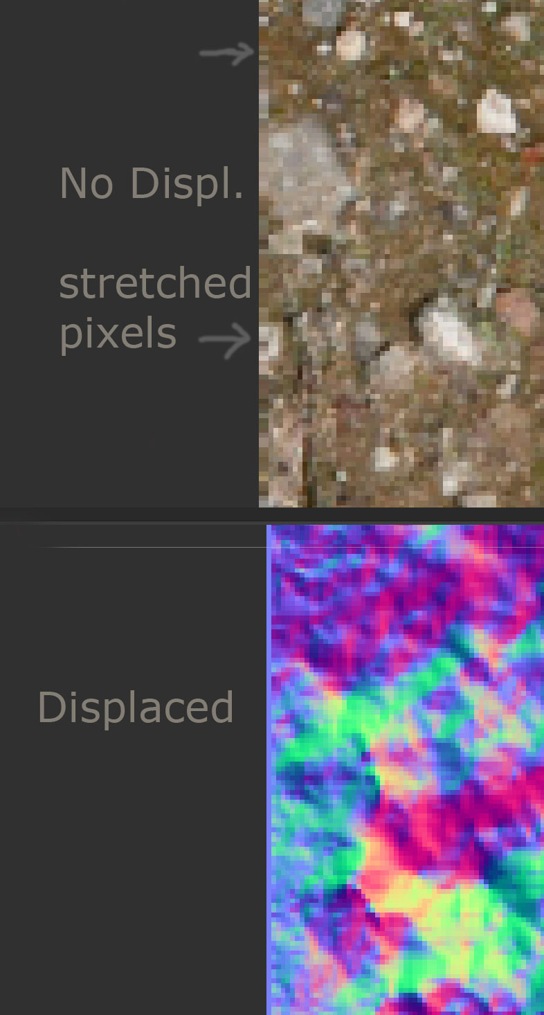

However I did notice when drawing out my uv’d plane on the canvas prior to displacing, I zoomed in on an edge (without framing) and the pixels were stretched for about 3 pixels on the left edge. With a normal map material applied it’s one pixel left and top. Not sure if this is just a drawing bug or the uv’s actually aren’t correct. It’s pretty wierd.
edit: come to think of it, I guess this happens because I haven’t done a render.
That’s a problem with your UVs.

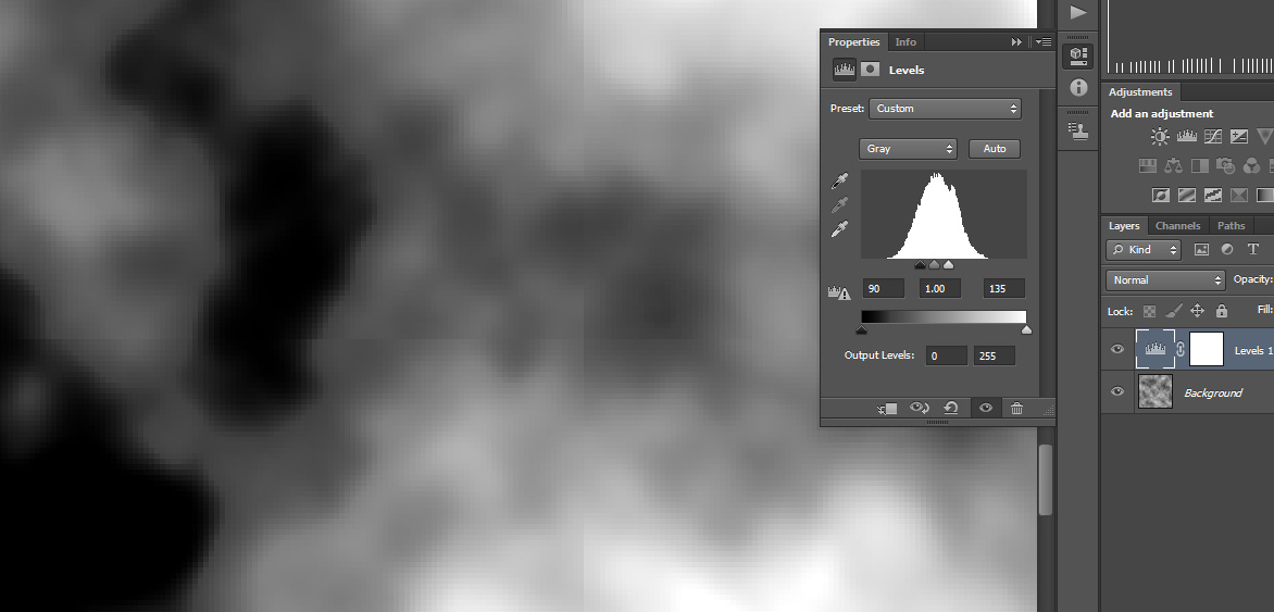

The displacement psd you sent has very slight lines. These show up (at 500% zoom) if you do a Filter>Other>Offset by 1024 horizontal & vertical, and then adjust the levels. The lines cross the image a little off center. 16 bit is great but you need to remember that there are many more levels of gray than the monitor can display or the human eye can see. You should be able to edit the image if you use an adjustment layer with levels set appropriately, so you can see what you’re doing on the background layer.
I did a quick test by using the clone brush in PS to get rid of the lines. I then imported the result into ZBrush and applied it to a plane divided to 16 million (for reasons mentioned above). This would then tile perfectly.
The image shows the alpha at 500% zoom and an adjustment layer with levels set to show the lines.
