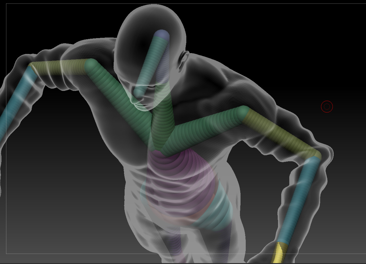

Im new to Zbrush, after creating my first model, i tried posing it using rigging. But im getting odd rippling in the mesh (see image). I used Dynmesh to model, then use zremesher. Used zspheres to build a rig then binded to the mesh. anyone know whats happening and how to fix

This is typical of a mesh that is too dense for ZSphere rigging. You could pose your model using the Transpose line:
http://docs.pixologic.com/user-guide/3d-modeling/posing-your-model/transpose/posing/
Alternatively, use ZRemesher to create a low resolution version of your model so you can pose using ZSphere rigging.

Transpose Master will create a combined mesh from the lowest subdivision levels but that doesn’t mean that those levels have a low enough number of polygons for using zsphere rigging. You don’t need to create a low resolution model to start with but you will find it easier to pose your model if you create one before posing. Done properly, you shouldn’t lose your high resolution detail.
A brief workflow might be:
  1. Create your model using Dynamesh etc. and subdividing to add high resolution detail.
  2. Create a duplicate of the model. It’s important that you don’t work on the original model, so save a back up file.
  3. Decimate the duplicate using Decimation Master. The aim here is to provide a good start for ZRemesher so as to reduce computing time. You don’t need to worry about all the high res detail - we’ll get that back later - but you don’t want to lose the shape of fingers etc.
  4. Use ZRemesher to great good geometry from the decimated mesh. This will be the new “base mesh”.
Now to get back the detail:
5. Subdivide the mesh created by ZRemesher until it has about the same number of polygons as your original mesh.
6. Append your original mesh as a subtool.
7. With both meshes at their highest subdivision level and the new mesh selected, project the high res detail using Tool>SubTool>Project All. This will copy the detail from the original mesh to the new mesh.
You would need to repeat this procedure for each subtool of your original model, if they have high polygon counts even at the lowest level. You’ll need to experiment with the settings for the methods above to get the results you need. After doing this you should find that it is much easier posing using Transpose Master and zsphere rigging.
