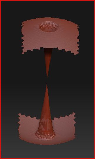

…without make holes or cracks?
What is your regulates?
it’s format “obj”
Thx by advance
I get this issue too. By creating a primitive sphere in Modo (nothing fancy) and directly importing into zbrush, I get some weirdness happening at the poles when divided. This seems to happen whenever there are many polys coming to a single point and it can be frustrating!
Is there any solution for this? Anyone please try any basic modelling package and see if a sphere imports and divides ok, its very easy to reproduce.

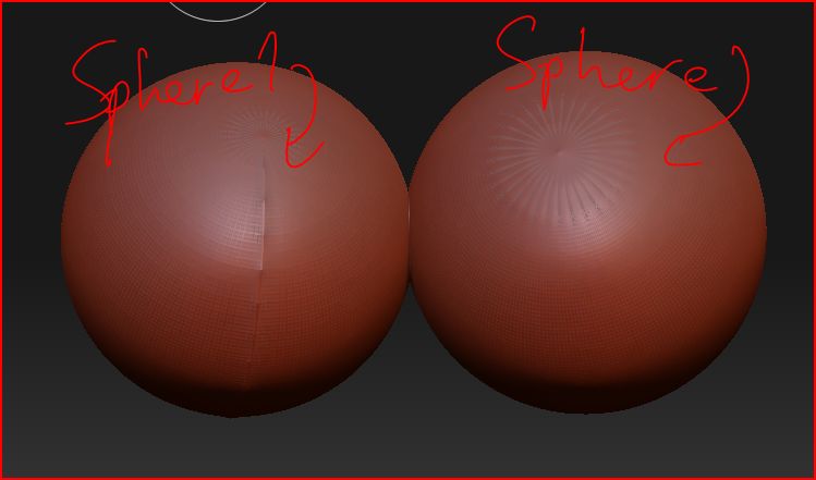

Sure : it’s just models from another progs !
For see the compatibility
By the way frenchy, sphere1.obj has a seam along the edge: (its an unwelded nurbs patch
- need to turn on weld in export) but sphere.obj is definitely a fine specimen.
