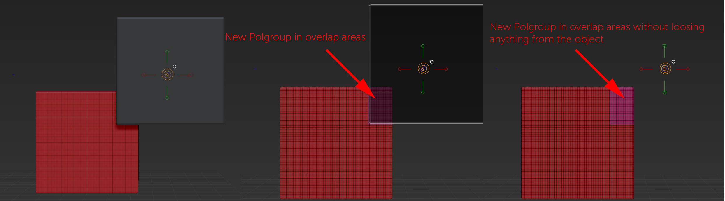

Thanks Doug.I was aware of the intersection mode but basically I am just after the polygroups that result from the intersection operation without actually changing or completely remeshing the object.
Basically currently I would use either the sliceCurve tool or ZMod Polgroup depending on situation/mesh density to generate a polgroup in the intersection area of Object A & B. But I find it too time consuming so I was hoping that there would be an option to generate a polygroup based on an intersection, ideally actually slicing Model A to generate as closely a polgroup match as possible.

Ok, I think it might not be possible as easy as I want it. But I attached a screenshot.
When using Dynamesh I can do two operations, Subtract B from A, do a intersection of A+B (copies), then do add from both operations.
But if I don’t want to dynamesh I guess I have to manually create my polygroups and/or do slicing.
Hmpf. Booleans on Polygroup colors would be nice
