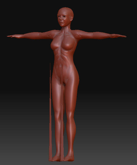

Fierndip- thanks for the SL_avatars tools, by the way I loaded em up in zbrush 3 and decided to try to help resolve the issue with the tools. As you say when you subdivide you get
Tried to upload the tools for you all but either its to big compressed or I dunno keep getting invalid post specified error, at any rate you know how to fix it if you have access to ZB2. Now mind you I have yet to try and sculpt them so no clue how that will affect them, though I think should be fine. The only other answer to the problem would be to retopologize the meshes which I didn’t touch either, they don’t seem to the be the best at the moment but decent I guess. Have fun and I hope it works out, I gotta try to help the forum out as much as I can!! :+1: :+1:

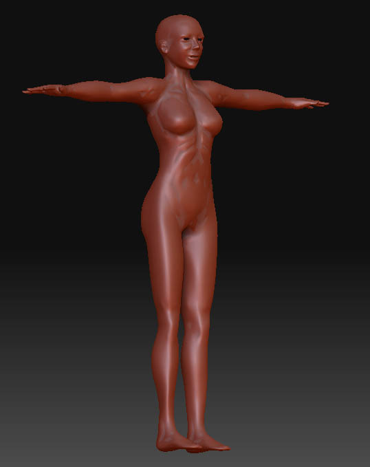

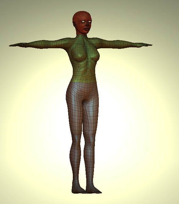

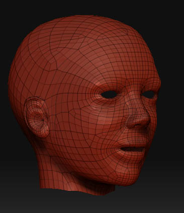

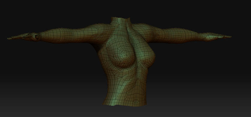

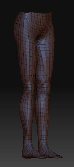

Flerndip- Well, if you do Shift-F or click on the icon that says draw polygroups in transform or on the classic interface on the side with the scale/move/zoom buttons, it has polygroups for the head/chest/legs.
Hope this is what you wanted, if not just send me a private message. I see you asked 3 days ago and I’ve not check in on this thread lately but usually in zbcentral every day. So send me a message and I’ll get back with you in the thread/private message faster. Then again I did have my inbox full lately :o ehehe but its clean out now :stuck_out_tongue:
Select Polygroups- Ctrl+Shift then click on a group you want.
Hope that helps
