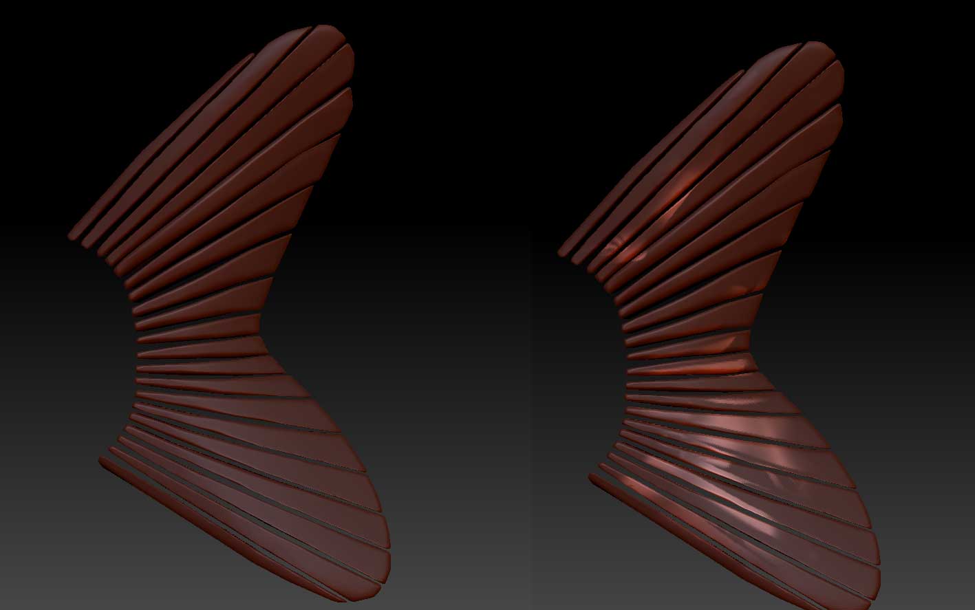

I have been having and issue with saving masks as alphas.
I draw a mask hit make alpha and the resultant alpha has missing parts.
see pic.
The mesh show in pic does this no matter what, whether how its was created or re-meshed.
mask from poly paint same thing.
any clues would be appreciated.
many thanks.

“Mask by Alpha” requires UVs and is just like applying any other texture. If there’s an issue with the display, I would look to your UVs. Getting a look at the topology in the problem areas here would probably be helpful as well.

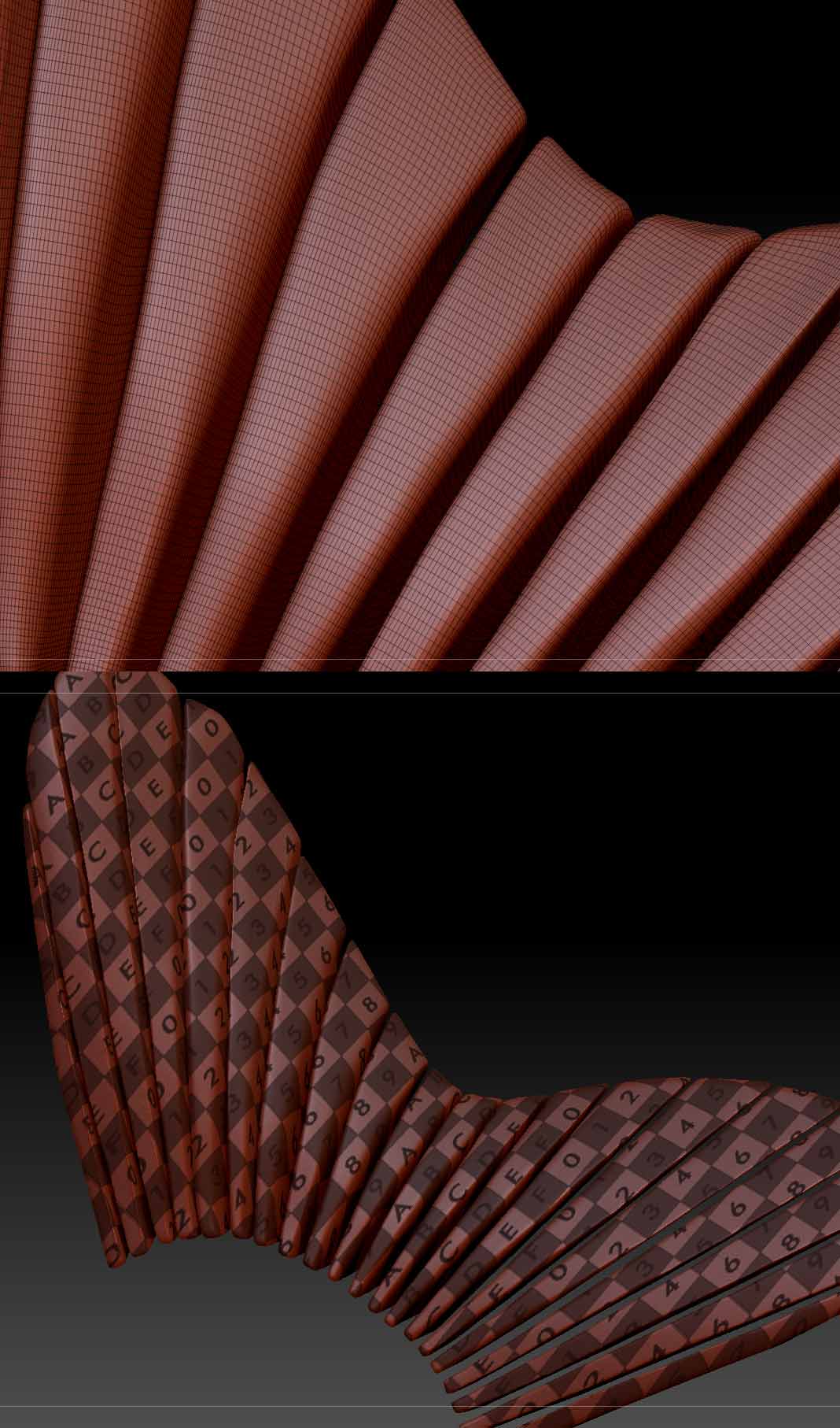

Attached is pic of a remesh topo and the number grid texture.

Otherwise, I don’t see any obvious issues. I haven’t seen what is going on with your UV layout, but you can test to see if it’s an issue with your UVs by duplicating the tool, and applying a new set of UVs. Use a different method than your previous mesh to ensure the results are different . For instance, if you unwrapped that mesh with UV Master, use Tool > UV Map > Create > PUV tiles. You just need some quick functional UVs that are different from your previous. Perform your masking and alpha operations again.
If the issue persists with a new set of UVs, you may need to explain how you are applying the masks.
