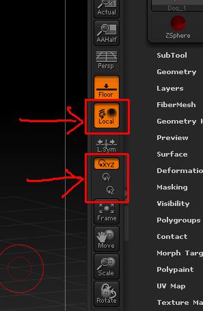

On the right of the interface are some buttons that affect how the object is rotated:
  • The Local button means that the object is rotated about the last edited point rather than the object’s pivot (central point). Turn this off to see if you can control the rotation more easily.
  • The axis buttons lower down. Try turning on the Y axis button instead of the free rotate. This will mean that when you click and drag your mouse horizontally the model rotates around the Y axis. You may find this more satisfactory than the XYZ free rotation.

Thanks very much. The rotate around y option did the trick!
