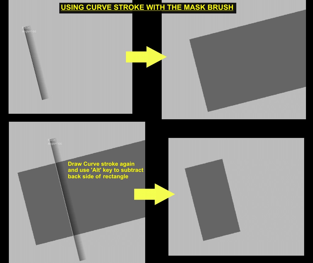

No, you can’t rotate a rectangle mask. You can use the Curve stroke to make angled rectangular masks. See image below. However this won’t work well if you plan on using lots of rectangles.

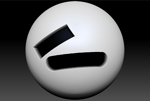

  • Fill your mesh with white and turn off zadd/zsub, turn on rgb.
  • Select the clay line brush and make your primary color black
  • Adjust your draw size (draw with shift if you need to, but its probably not necessary), and draw as thick or thin a line at the angle you want a rectangular mask.
  • Switch to white and paint off the curved ends to make the drawn shapes rectangle
  • Go to your mask sub palette and select: mask by intensity.
  • Perform your operation
  • Remove the mask and then fill your object with white to remove the black rectangles drawn.

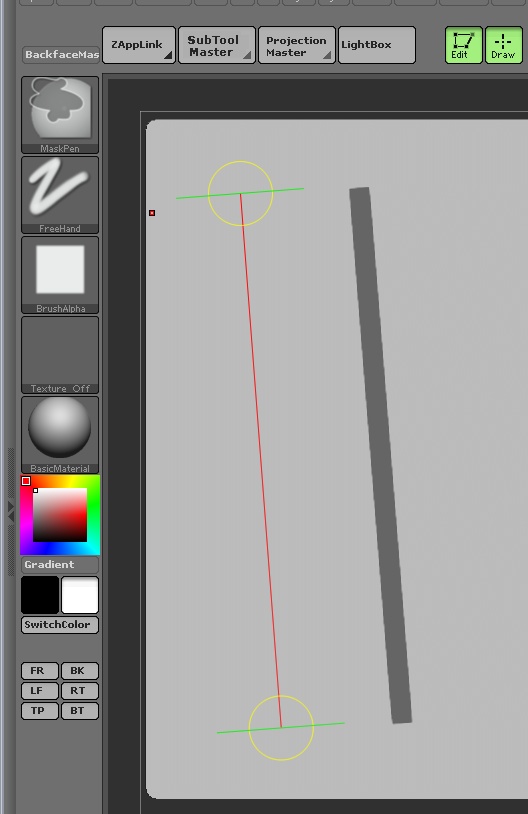

Or, you can use the Mask brush with a square alpha and turn on Stroke>LazyMouse>Backtrack>SnapToTrack>Line. Your line width will be whatever your draw size is.
That seems like the way to go! Thanks all for the tips! Highly appreciated.
