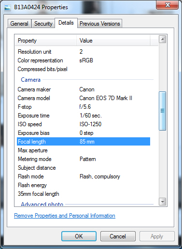

i have a canon 7D mark ii + 18-135 lens , it is a 67mm lens
but in different zoom i grab different mm !
and what focal length good for this camera ?
sorry for bad english

Not sure if I’m wrong but using the calculator you need to be in the top of your range in order to be able to use it as portrait, I mean basically 135mm in your lens will give real 85mm (more or less)
https://www.digified.net/focallength/
85mm will be 28.5 FOV, that would be what you need to set in Zbrush in Draw>angle of view

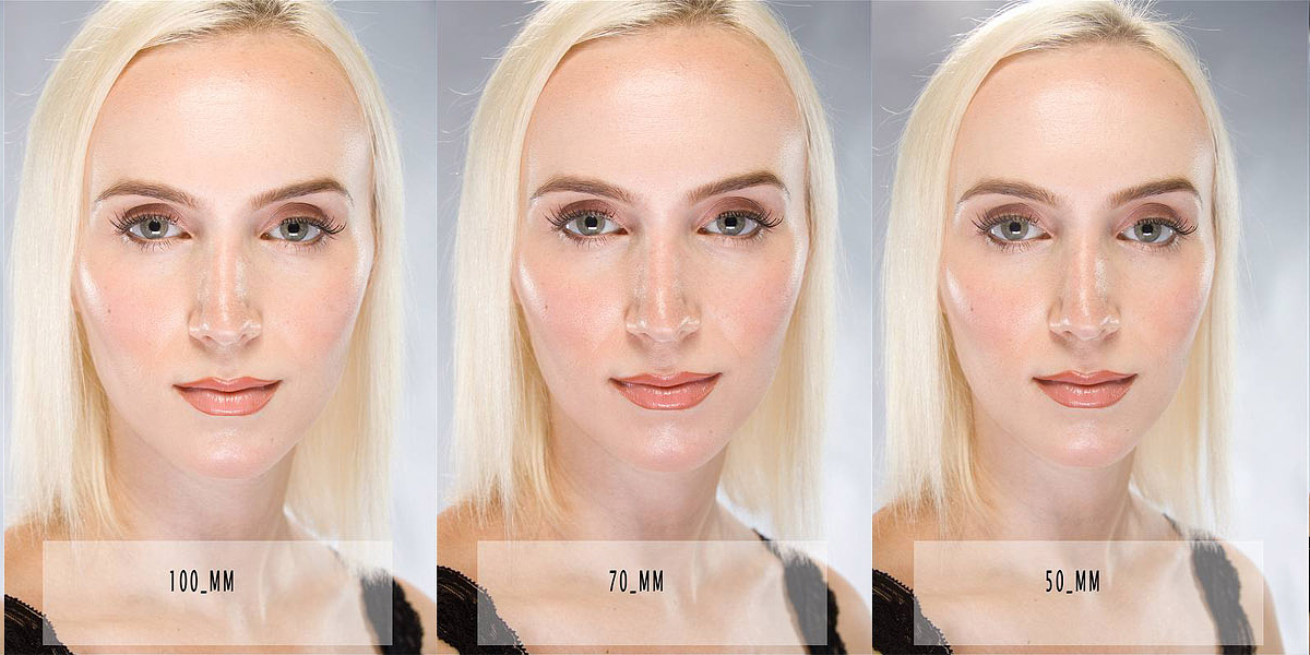

Interesting example of effects of different mm in a face. Be carefull about examples about this is internet as sometimes they crop the image, taking a 50mm with the subject far away and then cropping it. This would give obviously less distorsion and the reference should be a face filling in a reasonable way the frame with the head and neck. A full figure cropped is not a portrait from distorsion point of view.
http://stepheneastwood.com/tutorials/lensdistortion/strippage.htm
