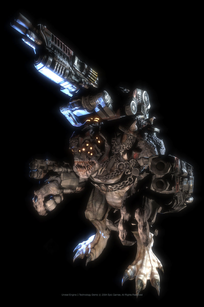

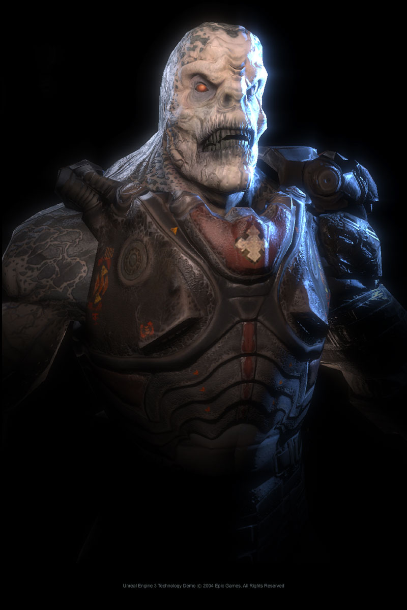

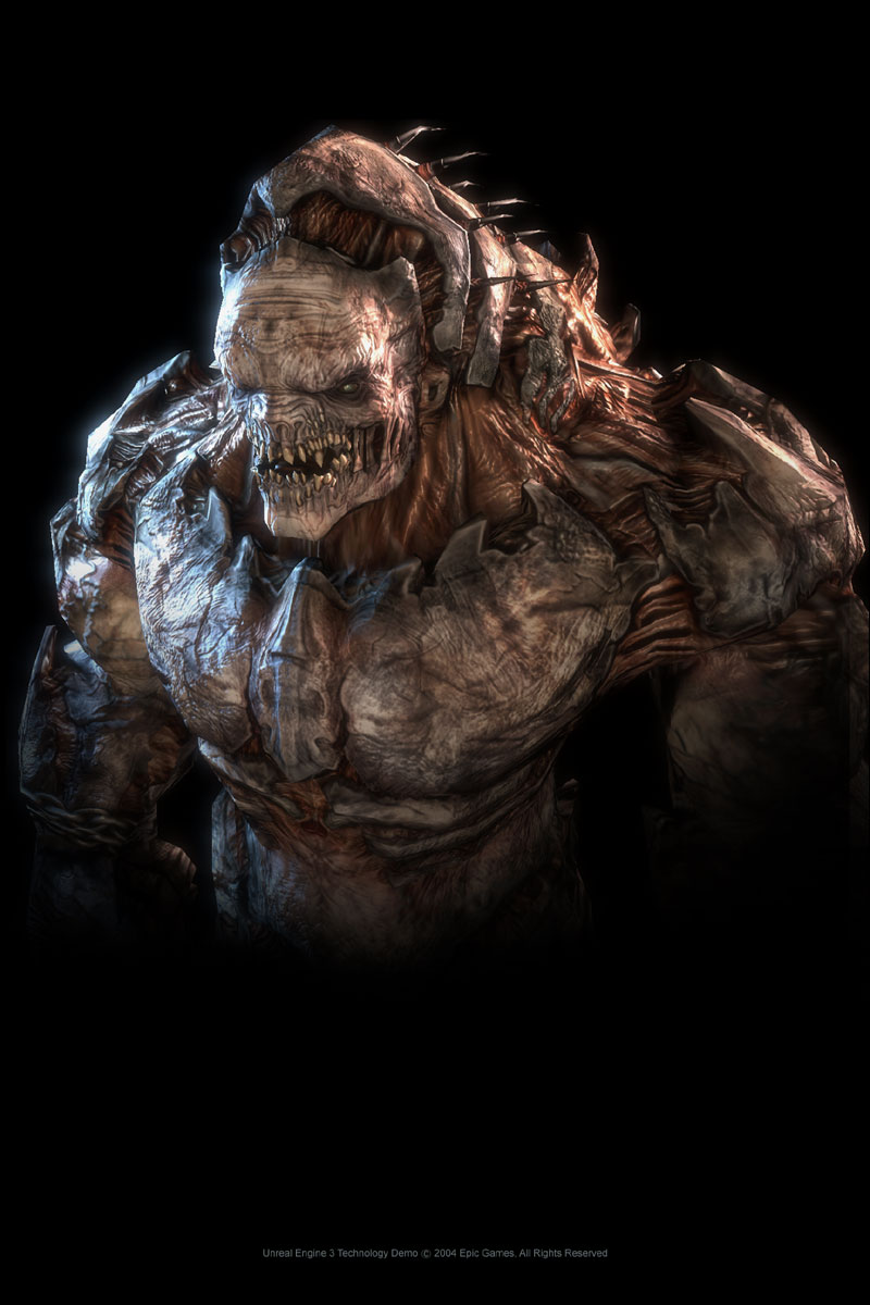

I have a question about all this. I love the results I am getting but the whole subdivision surface thing can’t be the only way to get this effect. For instance how the hell are they doing this level of displacement… and in real -time!!!
I know you can see the edges of the polys but just look at the detail. Maybe someone out there can write the equivalent of a pixelshader for displacement we might have better luck. Then again I don’t understand how these things work and may be wrong about them using diff. methods.
Any ideas?
based on the outer edges, it looks to be a wonderful normal map. zbrush can make these for you in addition to displacement maps.
So what is the deal with normal maps? Is there a reason they can’t be used in combination with displacement maps? Seems like you would be able to get spectacular results from a medium res poly model using both methods, since you wouldn’t have to worry about rendering it real time.
Maybe like a displacement map that falls of along the incidence angle so that it doesn’t effect the edges facing the camera since the normal map would handle that…
I don’t know just throwing ideas out.
