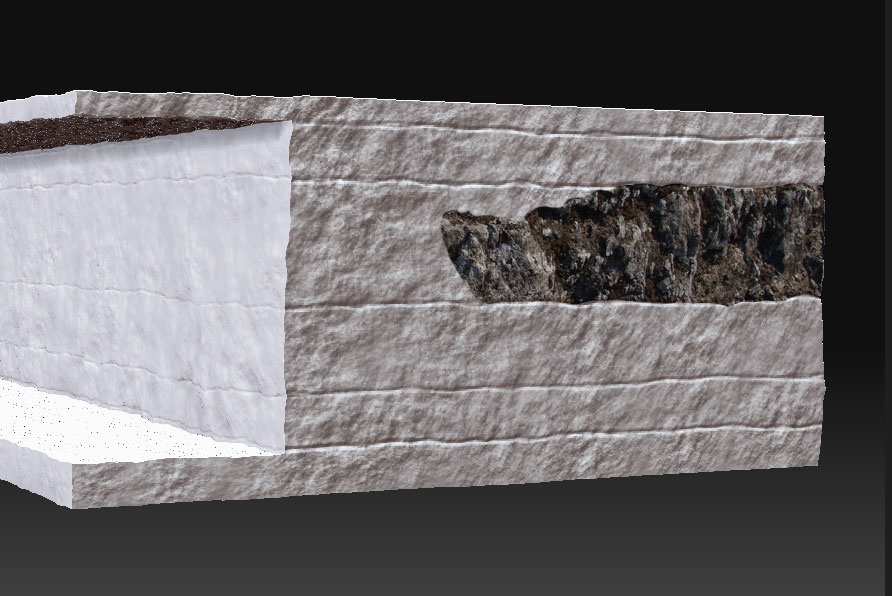

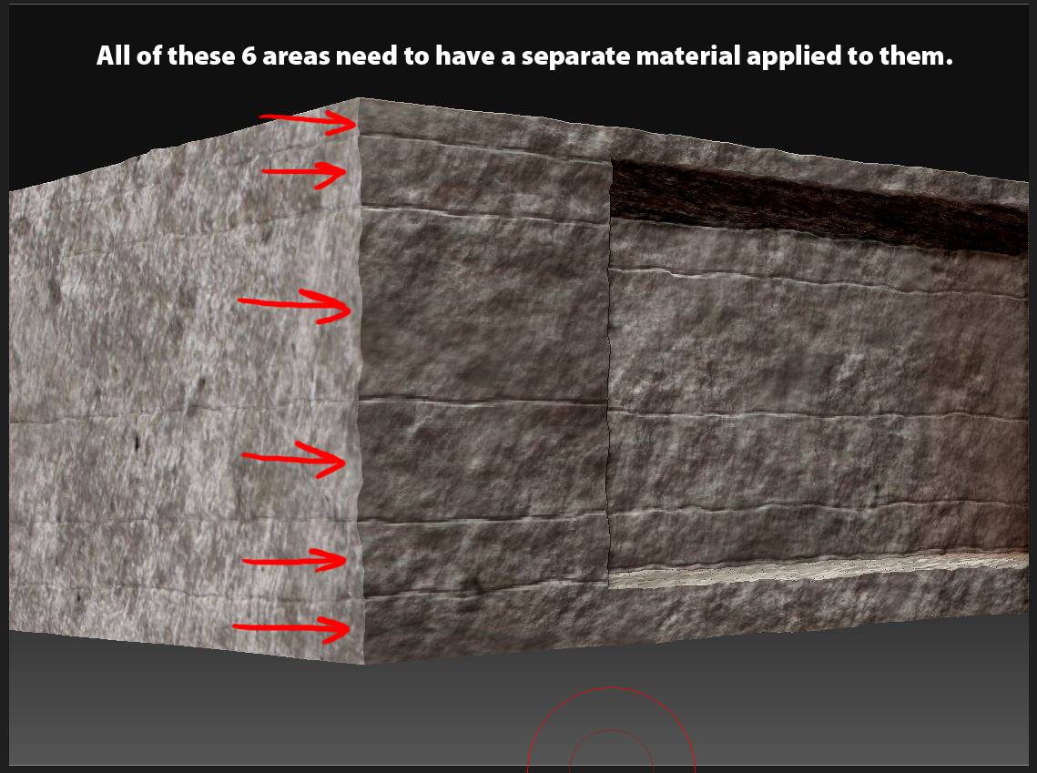

I am having the hardest time painting in a particular Polypaint on my model. Imagine painting 6 different layers on a brick type object, but each layer of texture cannot overlap the other layer, but the layers have to be jagged.
Question #1
I tried to Mask off each layer separately, but it proved to be too time consuming as each separate area has jagged areas so I am wondering if it is possible to save out a flat map from ZBrush so I can paint in the materials in Photoshop?
Question #2
I was using the “Drag Rect” and a material to cover the separate areas but the texture would just low into the other area, but if I used the Stroke, Freehand or Spray brushes the texture would tile way too many times and I don’t want it to tile when painting. Is it possible to paint using the Stroke, Freehand or Spray brushes and not have the texture tile when painting?
I am using ZBrush 3.2 for mac.
Thanks :slight_smile: brick_2.jpg

As far as how to paint multiple materials, your object seems fairly simply to mask off section by section with simple rectangular masking, then polypaint in the new material. If this produces a line division that is too “clean”, you can then go over the line again and "“rough up” the division with a little detail brush work.
Sorry, let me try to clarify.
  1. First I want to know if I can you save out a flat UV map and paint on that in an image editing app like Photoshop or will I have to create an UV map in 3DCoat. When I use “PUV” I get a texture that is in small cubes and I can’t paint on it in Photoshop so I want to know if I can export a Flat UV map from ZBrush?
  2. Using “Drag Rect” and a material to cover the mesh works for broad areas but does not allow you to manually Paint the material in small areas, So I am asking if you can somehow set the “Stroke, Freehand or Spray” to paint the material as one “untiled” material. (see image)
Imagine you have an image of a house and you want to paint it across a cube using the “Stroke, Freehand or Spray” brushes, (not the Drag Rect stroke) so you don’t want it to tile the house material when you are painting it. Can this be done via a setting? All I want to do is paint my texture using “Stroke, Freehand or Spray” so when I am painting the material is not tiling.
Can I "Paint" on the material so it applies to the surface "untiled"? (See Image) I know I can do this using the DragRect Stroke, but the Drag Rect stroke cannot apply the material like a brush whichis what I want to do?
