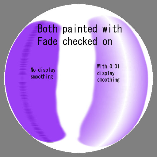

Must have Display smoothing set to 0.01 or greater for fade to work. Thats all. Thought Id share this observation with you. It is mentioned in the Texturing Quick Start PDF, but since not everyone downloads that doc. several users here have been frustrated with nasty seams at the edges of their models despite having checked Fade in the PM options pane.
Here`s a ball I textured twice in Projection Master, both times with Fade on, but first without any display smoothing, then again with.
Cheers,
R

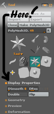

Hi Rory_L
Can you tell me exactly where is the option ? in which pallete ?
Regards
sunny
Hey i really appreciate this…
Helped me out a ton…
I have been using ZBrush for a while and have been getting very frustrated with the texturing procedure…
I guess this is 1 little step that i read right over,assumed it wasn’t that important, and forgot…
So thanks alot for the great tip!
Thanks buddy
That will help a lot
Regards
sunny
