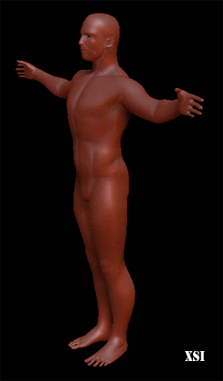

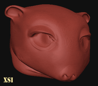

Was curious so I made a quick comparison image… XSi vs Z vs Z orthographic
seems not TOO off imho, it’ll good enough for me— much better than working in ortho.
do a cross. or a character in a divinci pose…and do that example again.
it’s good enough for the artiste inside of use… :+1: :smiley:
I agree there’s a slight difference but I’m quite happy with what we got.
[zpersp2.gif]
ortho was really bad to work in
that’s really great to see!
how do focal length values relate?
Have no idea. F.L. in XSI seems to zoom in/out only, not distort the model in a perspective manner. Only moving the cam does. I’m not an expert in photo/lens things.
