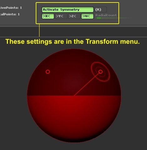

re: “creating a Z-sphere rig”. I can’t seem to “turn on symmetry mode” correctly, as my Z-shere only has ONE dot and not two as Paul has on the vid. Can someone direct me how to get the two dotted Z-sphere? A clearer screen shot with the correct settings would be great.
Thanks!
See if your symmetry settings are set as below.
If you have the above symmetry settings set the same and you still only see one dot, then your zsphere might be snapped to a side view instead of the front view. If that’s the case, rotate the zsphere until you see both dots then hold Shift while rotating to snap it to the front orthographic view so you have a dot on each side.
