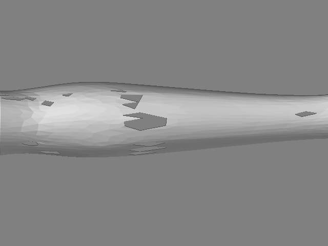

I still have one question about obj file. I export model to an obj file. Do
some editings in other application (In Rhinoceroces, reduce polygons and
weld them together to one group only) and export to a new obj file.
When I reload the new obj file into ZBrush, select the smooth brush to
sculpt. It become several broken meshes. Why these happened? Is there
any way that I can load obj file from Rhino and do smooth-sculpting in
ZBrush without breaking the meshes?
Thank you again for your reply.

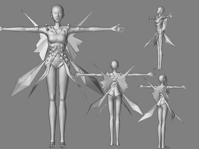

Hi,
How do you feel about this model. Any suggestions and comments are welcome and appreciated.

Your mesh looks pretty cool so far…patience my friend…we’ll get ya up and running and happily Zbrushing in your dreams, at work, in your car, etc in no time!:wink:

Better now. But still broken somewhere. I press down the Merge button and set the
weld> .01
tri2quad > 70
Any solution?

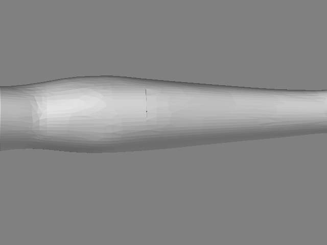

before smooth-sculpting
Thans for help. No wonder I enjoy looking and talking here. There always be lots of amazing artworks and kind advices. Can’t help stay here even it’s such time-consuming. :stuck_out_tongue:
hmmm try it with the tri2quad between 35-45 and see if it still does it. That seems to be the best settings for that…so far for me anyways. If I go lower or higher I run into similar problems sometimes. Also try the first and try it without merge on but leave the weld at .01.
Somewhere I saw a tip from Aurick about also doing crease function after importing I think with above settings but before drawing the tool to not necessarily close the holes but force them to be closer. I think it was crease…in any event if the above stuff doesn’t work or someone else doesn’t come up with something to try…I will try to find that tip and see if that works on a hand model I have that has a hole that shows up around subd level 3 and if it works I’ll let ya know.
Still doesn’t work.
