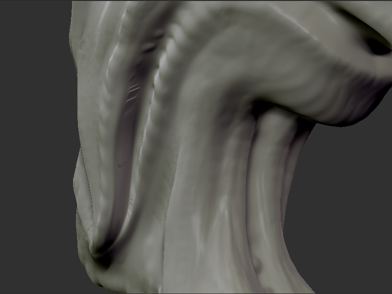

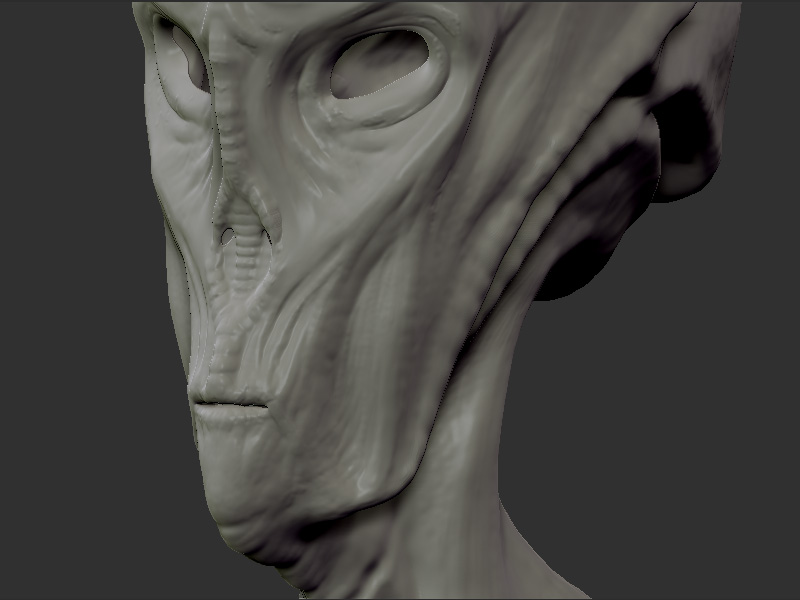

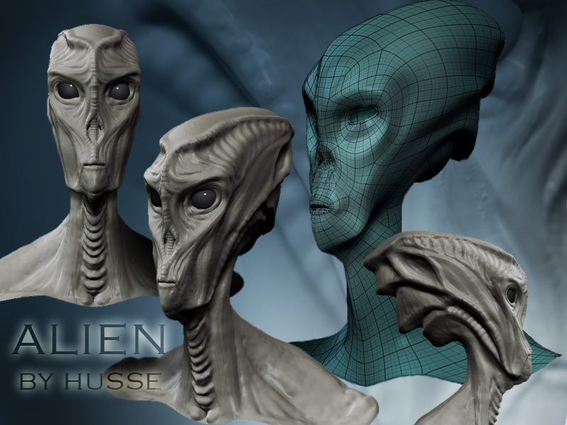

I made this Alien dude with quite a lot of detail just to have something
to practice retopo on, this is how it turned out.
I would appreciate it if you guys could take a look and see if i´m on the right track on this retopo thing. Is the flow ok? Could I have made it different?

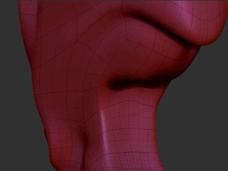

and yea your edgeflow looks fine- seems like u pulled it off nicely. i think the problem with the back is that theres not enough polys in that one spot to project the details right… the deformed polys are right over the point with 5 intersecting lines, that should usually be avoided, especially when u have details everywhere. you can always sculpt that new mesh, and retopologize again. You can even decimate ur model a few times, sculpt some new details and then retopologize http://www.pixologic.com/zbrush/features/decimation/
Thank´s konjo! I see your point on the funky area. I must fix that.

The retopo is too far away from the bottom of that crease. You could try moving the points closer or increasing the strength of the Influence… or something like that in the retopology section of the tool menu.
Thank’s Drakaran!
I think I will add some mor polys and move the edge line in a better way.
