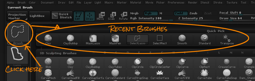

Problem is that the only sculpting tools that you need, clay, crease, smooth, grab and scale are hid in a cluster**** of brushes and just opening it up gives discourages me from even continuing
You can save your favorite brushes in a custom UI.
You can also easily jump to brushes by typing B, then the first letter of the brush. To jump to clay brush type b then c…
Recently used brushes also show up in Quick Pick (when you click on the brush)
