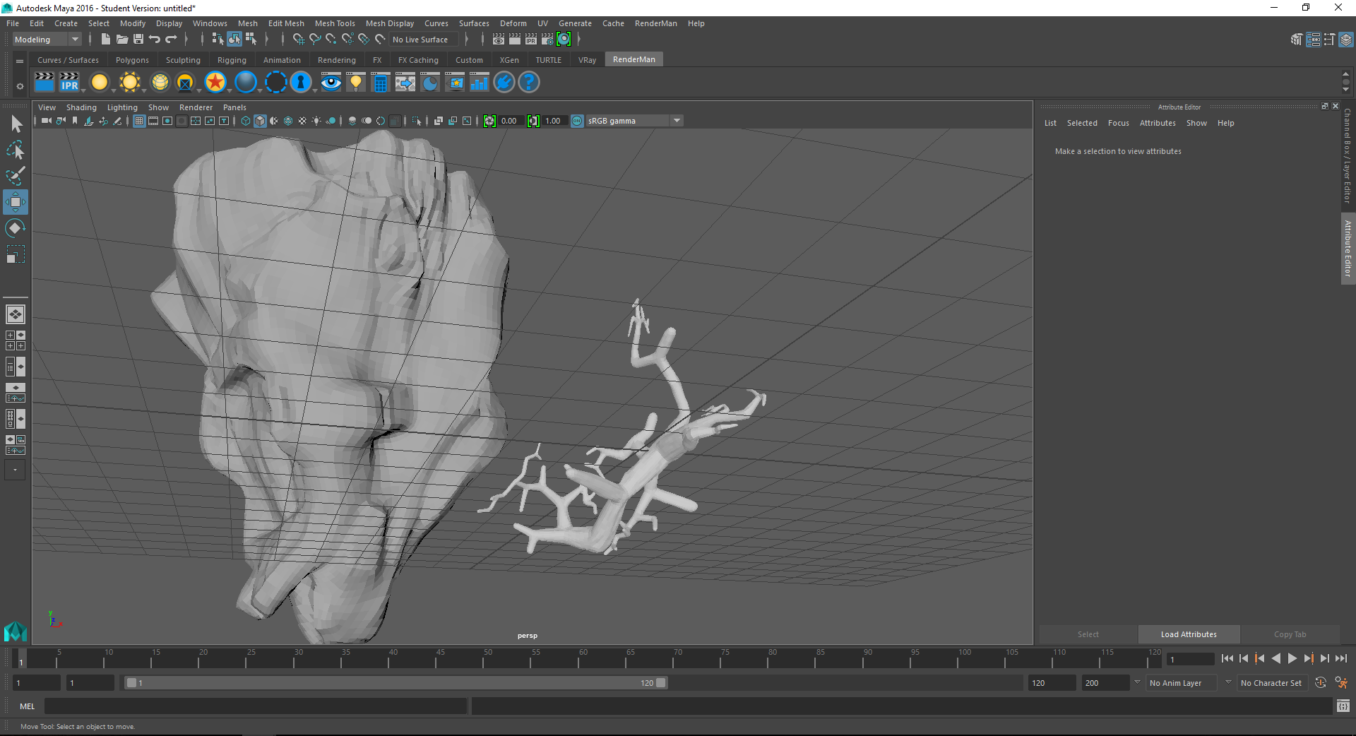

Ive sent a basemesh from maya to zbrush. But, after sculpting the main base mesh, i created more objects in new subtools. When i send all objects back do Maya just my main basemesh back to your original position and scale. The others subtools are imported in the middle of mayas viewport with a different scale. How can i do to export from zBrush and the objects still together in maya?

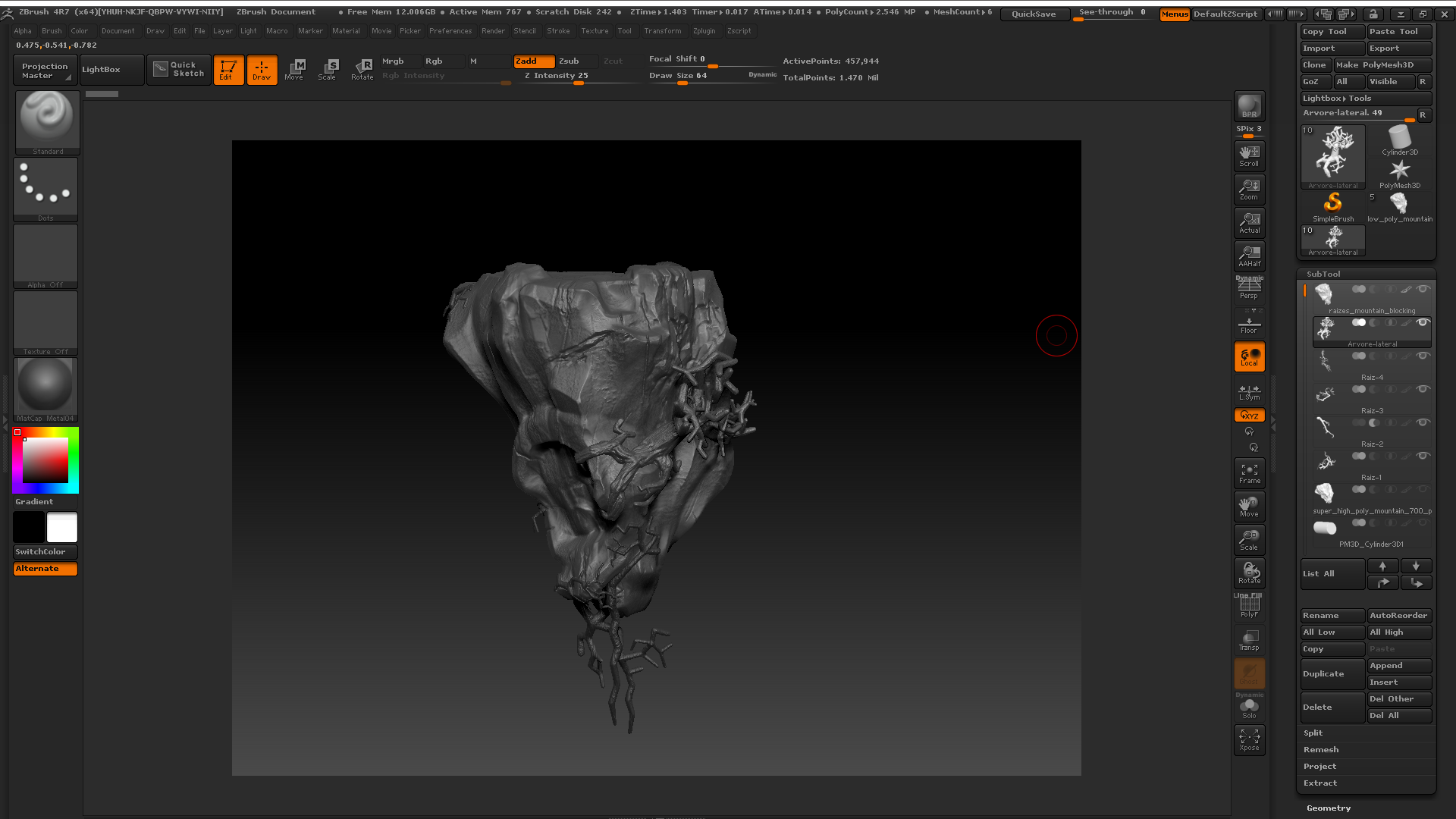

Yes. All the objects were exported using tool>export . Take a look to the pictures.
The mountain is the basemesh imported from maya, and the roots and tree are the subtools created in the same zbrush project. When i open all my low poly version of objects in maya they appear in different position and size. Just the mountain have the right size and position.
Wrong tool>export (go zbrush).
Bottom of the tool menu is a sub pallet “export” - There you will find scale and offset sliders.
Make sure those line up.
