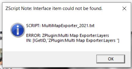

huuh
Seems this problem has returned to lucky ole me
Help pwease =D
