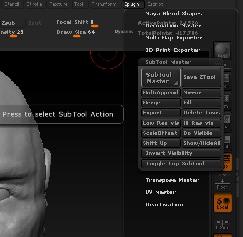

Here I click Zplugin and Subtool Master

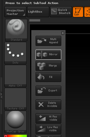

After doing so it opens up the Subtool Action window on the side where I select Mirror

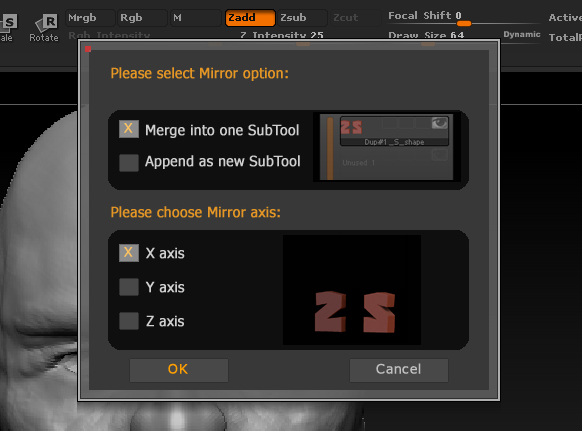

Afterwards the Mirror Option window opens and I select Merge into one subtool ans X axis
After selecting OK a completely different Poly sphere than the one I used to create the eye and then this happens :confused:

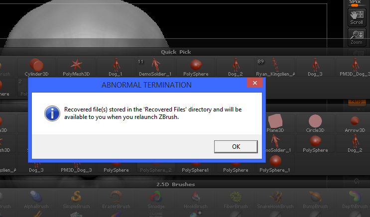

After I Undo what I just did I try the same steps again and then I get this error. What could be happening?

Many thanks, that’s very useful. Try renaming the eye subtool before mirroring. You have a lot of tools in the Tool palette which begin “PolySphere” and that may be confusing the plugin.
Does the sphere you are using have subdivision levels? If so then it is possible that when you undo the mirror action and try again ZBrush is becoming unstable which results in the crash.
Thank you very much Marcus! I was able to mirror the sphere sucessfully! I removed the subdivision levels from the polysphere and renamed it. How do I remove the unecessary tools from the tools palette?
