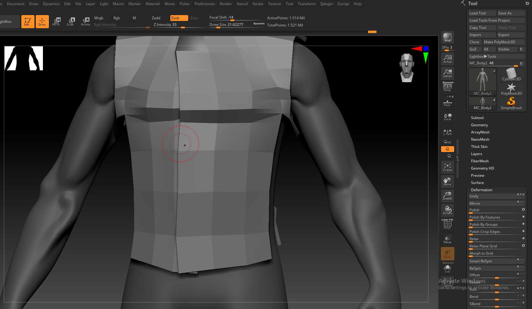

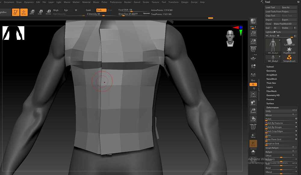

Hi, I realised there is symmetry issue during sculpting on the mesh. I saw few fixing tutorials where it says to do mesh and wield. While doing it, it actually duplicate the issued part so I need to flip it. I tried to flip it going to deformation and pressing "Mirror’. But nothing happens. Can somebody help pls.

I checked on subtool, nothing is masked and yes I freeze subdivision levels before doing deformation> Mirror. I even try deleting the higher subdivision but no success. Mirror and wield works well though, only problem is it mirrored the issued side.
