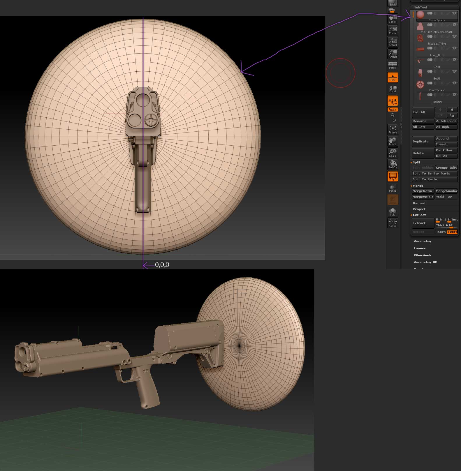

Do you have a screenshot of your mesh, and where the world center is (/ the center of the top-most subtool?) LSym is doing the job for me.
Actually, now that I’m trying the same thing with the larger subtool in my real scene (instead of the test scene) I’m still getting the problem.
I created the 0,0,0 sphere in max and exported it to zbrush after having done a lot of work in zbrush on the other subtool. Maybe I need to start by importing that sphere and merge the subtools of my gun after…
Here’s an image. I tried mirror (derformations) on the sphere that is perfectly at 0,0,0 and I get the problem. Same with other subtools.
This is what I currently get out of it.
From the last image it looks like the sphere might be offset based on that visible axis indicator. If you open Tool: Geometry: Position, is it zero’d out?
Ah! On closer inspection, it was off to the right by a few millimeters.
I tried creating another big object in max again and made sure it was dead center before exporting and when I got into zbrush, it was still off to the right… there’s a problem with the export of max or the import of zbrush… Very strange.
