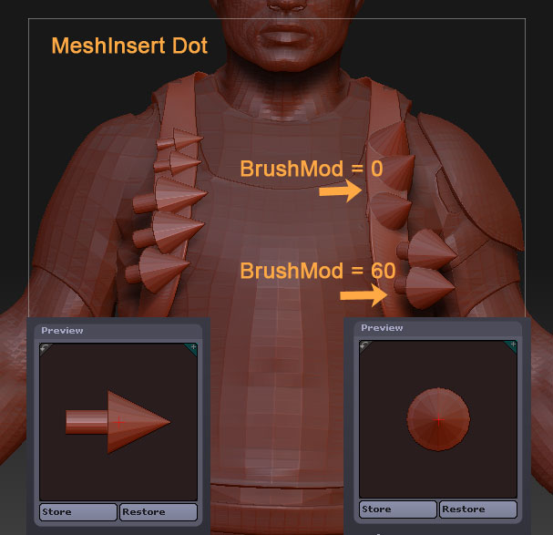

There are three things that affect how the mesh is inserted:
  1. Brush palette: MeshInsert Dot or MeshInsert Fit - Dot inserts the mesh tangent to the model surface; Fit inserts it drawn in the screen plane.
  2. The BrushMod slider and the inserted mesh’s pivot point. By adjusting either of these you can change how much the mesh is embedded. The pivot point is normally in the center of the mesh. You can change it by dragging the little red cross in the Tool:Preview window, then pressing Store to save the change. Alternatively, adjust the BrushMod slider in the Brush palette.
  3. The inserted mesh’s orientation. You can change this by dragging in the Tool:Preview window, then pressing Store to save the change.
