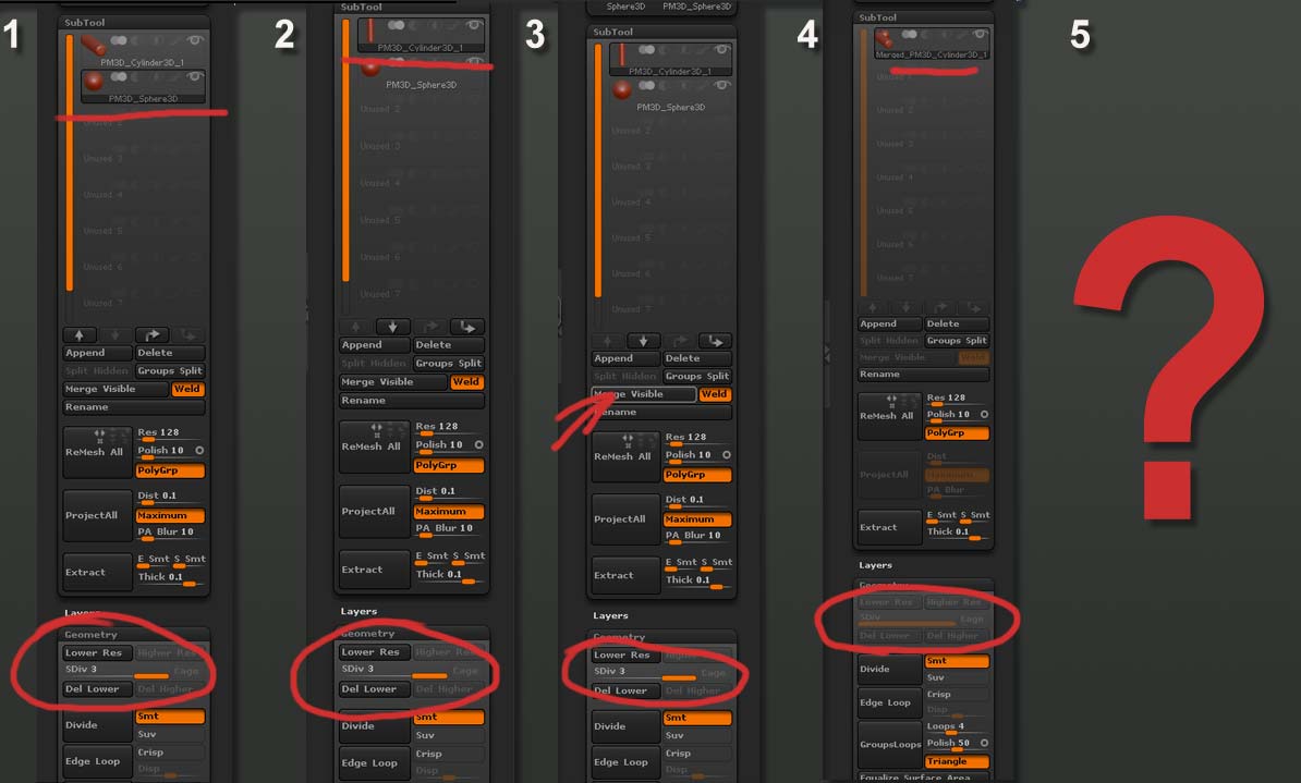

Sorry, my english very poor. I’m from Russia ;).
I use learning DVD “Eat3D - ZBrush 3.5 - A Comprehensive Introduction” (http://eat3d.com/zbrush35_intro ) for understand Zbrush 3.5. Lesson 09 Subtools.
Author, Michael Pavlovich, make following (image below)
2 subtools (PM3D)
  1. First subtool - 3 subd. levels.
  2. Second subtool - 3 subd. levels.
  3. Press “Merge Visible” button.
  4. I have new Tool “Merged PM3D_***”. No any subd level.
  5. ???
It bug with my PC or ZBR. Anybody have similar problem?
Thanks.

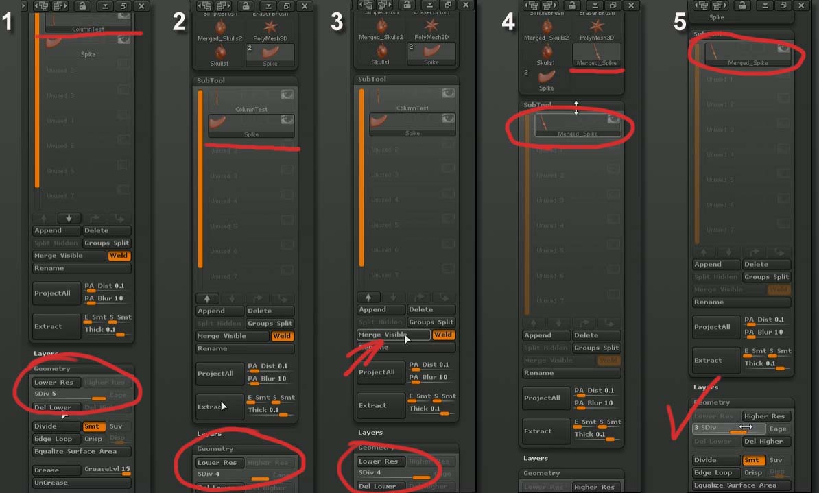

I am having the same issue - it seems to work fairly well for me when I have less than 5 subdivs, but never has worked with over 5.
Example:
Have a subtool with two clumps of polygroups, each clump has approximately 20 polygroups (wrist guard for each arm) and I need to separate this single subtool into two subtools for ease of manipulation, tumbling, masking and ultimately higher subdivisions for detailing). After group splitting, I have tried merging visible at the highest and lowest level of subdivision as well as deleting lower at the highest level of subdivisions and I ALWAYS get the same error message when I attempt to Reconstruct Subdiv “Reconstruction result: Unable to reconstruct lower subdiv-level. operation canceled.”
Any ideas?
I have done a few tests and it seems to work each time for me not based upon the number of subdivs, but on the subdiv I am on at the time of merging.
Example:
If my model has 8 subdivs, I can successfully save 7 levels of subdiv if I am on level 7 when I export - I only lose the top level. When I have 7, I only lose the top one if I export at level 6, but if I export at the top level I am unable to reconstruct once I am over 5 levels of subdivision. Seems this is likely not the way it was intended to work so it is probably a bug they know about and are working to fix. I am willing to work with just losing the top level - much better than starting over - still would be nice if this was fixed in the next update.
Well, after further testing it seems that it is totally random - I normally find that in the end it is usually user error once I find a solution, but I am doing the exact same thing and getting different results each time so … /shrug … help? lol.
Ran into another problem with merge visible today that should be listed here.
Sometimes the polygroups are reordered randomly when I do a merge visible. If they kept their integrity this would not be a major problem normally, but if the sometimes tedius work has been done to create creases based off polygroups the crease will be gone and if work was done at a higher level all work will have to be trashed and the model taken back down to level 1 to be recreased and then worked back up - of course there are other ways to get the details back such as reproject, etc. but it is just a pain to have to constantly be redoing work you already did because of what seems to be a bug.
Another problem is when it reorders the polygroups completely randomly - such as a poly in the middle of a flat face gets its own assigned poly group and this happens all over the model - then all polygrouping work has to be redone.
