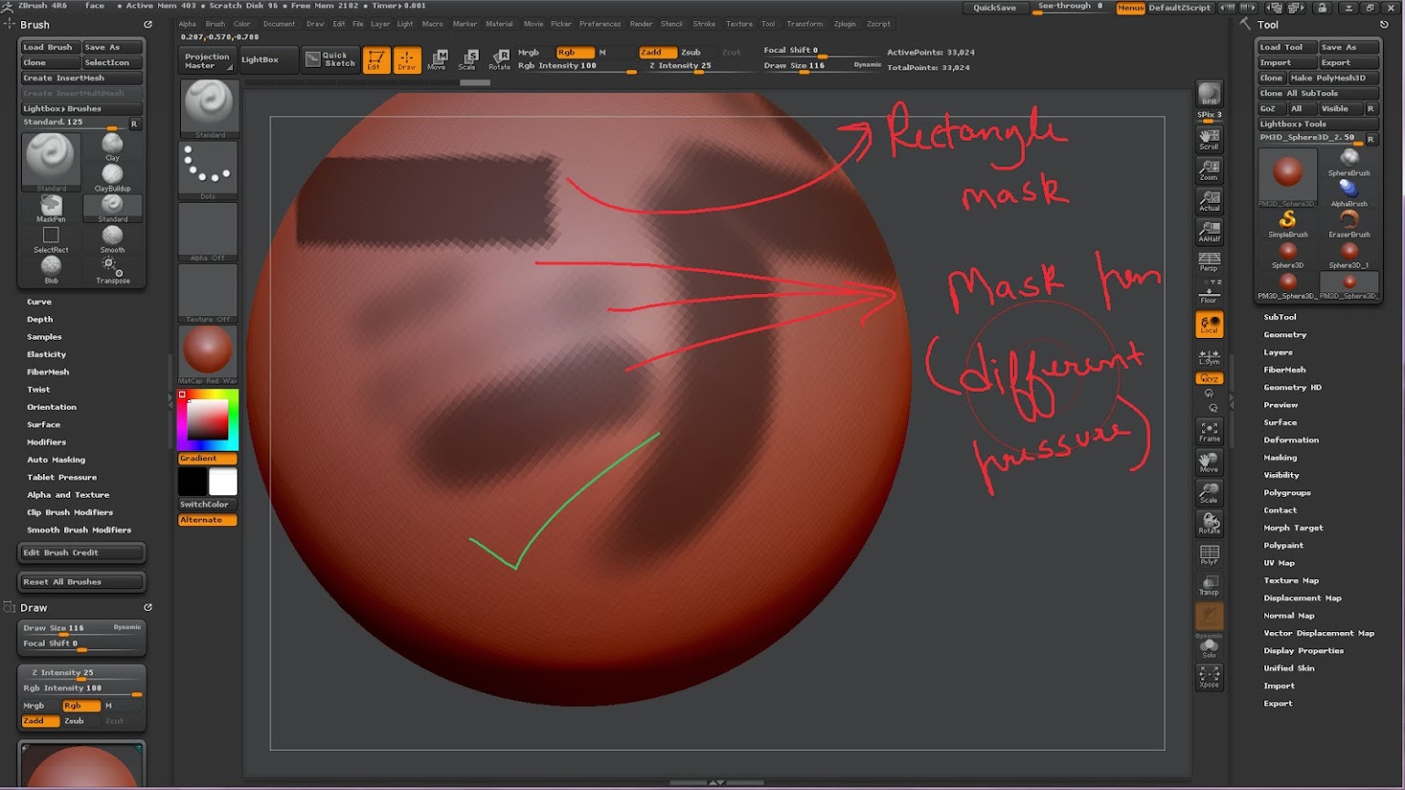

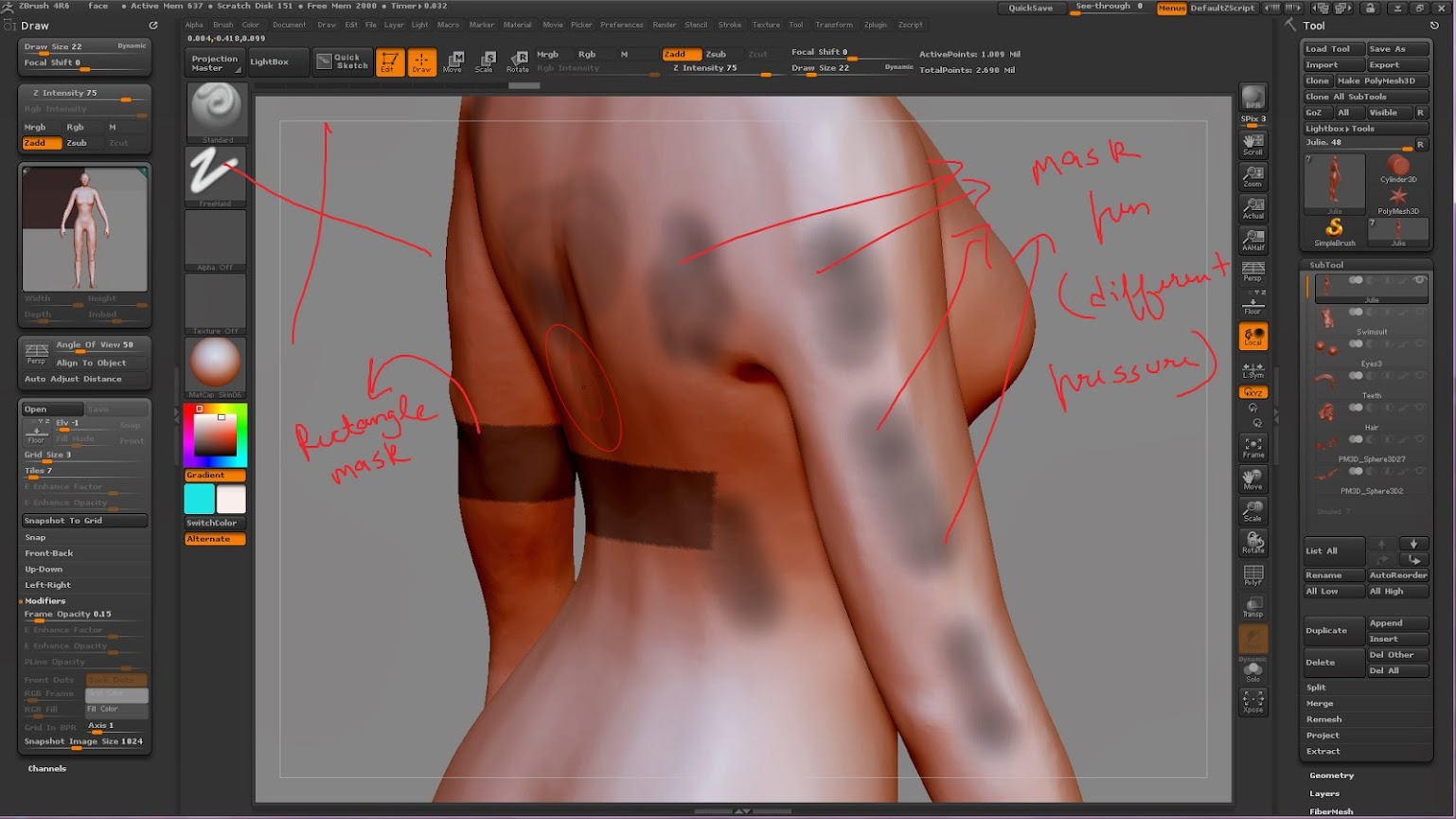

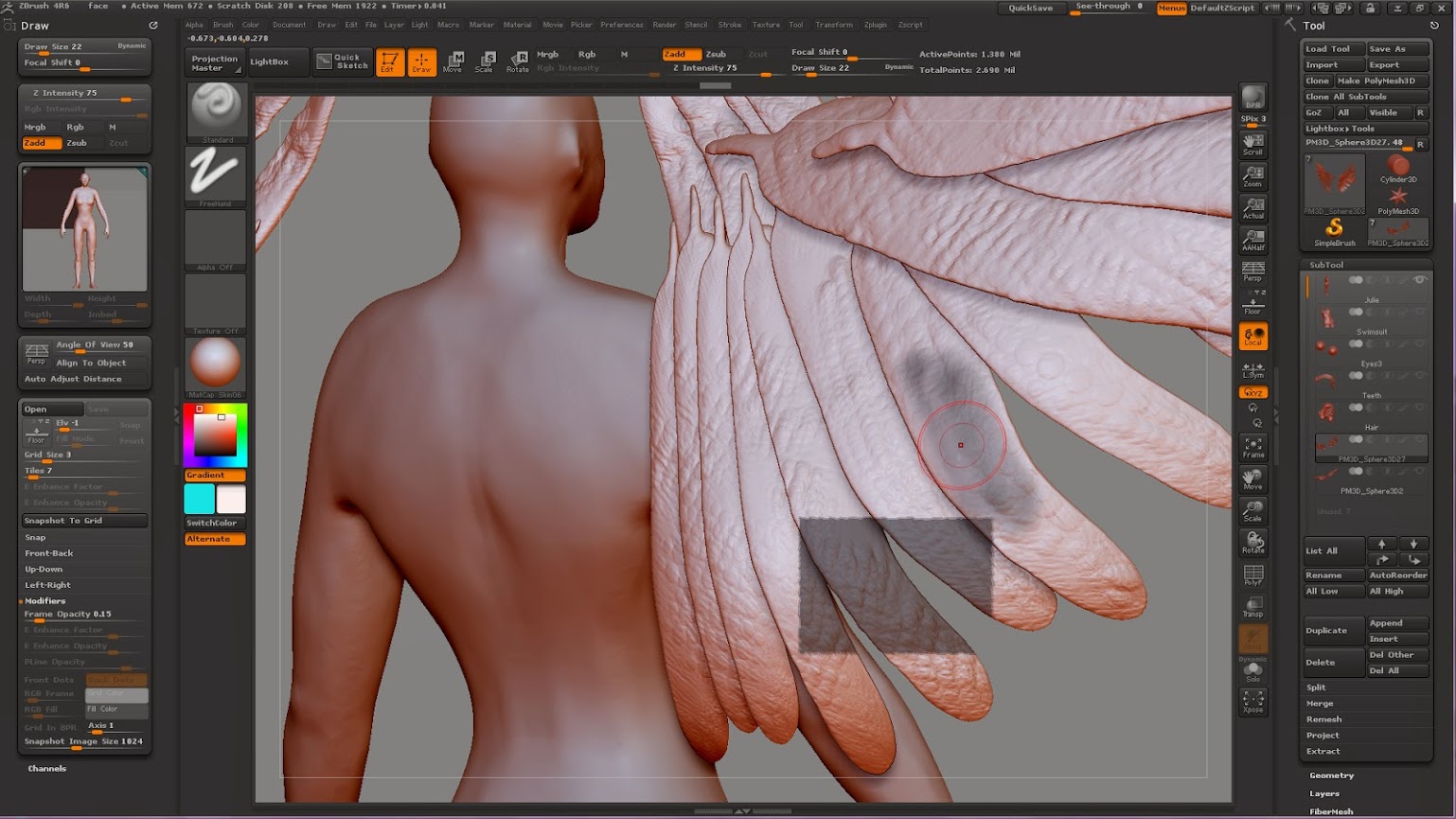

Hello people , I’m new to Zbrush and this forum as well. I’m working on a simple model . I save my work as a zbrush file side by side (not tool ) . In one file , my mask pen is acting weird. When I use my moues / pen-tablet for masking , it is very blurry and ineffective. But when I use rectangular mask clip tool , it works fine and I get a nice sharp mask. How do I fix this?
All the subtools in that file have this issue.
I can’t attach images I guess because I am new to the community .Sorry if I break any rules or something.
What I’m trying to say is this :
Same file different tool :
New file , how I wish mask pen tool to work :
I’ve tried setting my tablet options to default under preferences and for mask pen brush settings. Thanks for help in advance :slight_smile:

The mask is happening in a weird way . If I overlap mask on existing masked area ,the mask in that area kind of shifts . It’s hard to explain .
