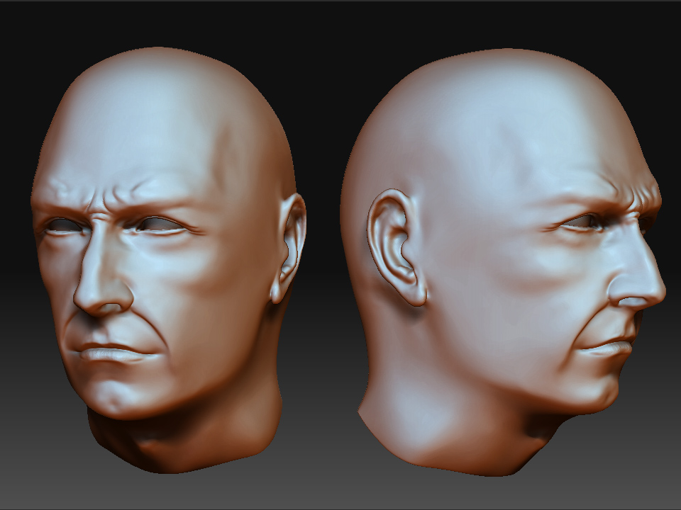

Just spent a couple of hours tweaking along the suggested lines (squarer head, wider forehead, corrected the naso-labial fold, made the ear stick out more at the back, remodelled the back of the skull and corrected the neck, made skull widest behind the ear…) I’ve left brow and jaw with the same basic structure as I will go for this slightly slender head. I’ve also tweaked the eyes and eye sockets.
I’m not sure I see a great deal of difference but I hope it’s better overall. MaleHeadWIP2.jpg
I’ll work a bit more on the ears before moving on to the detailing.

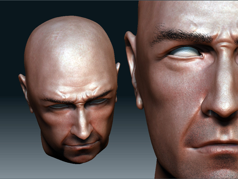

Detailing and texturing. C&C still welcome. I’m not quite finished yet :wink: [attach=80898]MaleHeadWIP3.jpg[/attach]
Nice texturing. The model is coming along well. Can you post more angles (front / left / right) so we may provide C&C on form.
Reminds me of Paul Weller btw. :slight_smile:

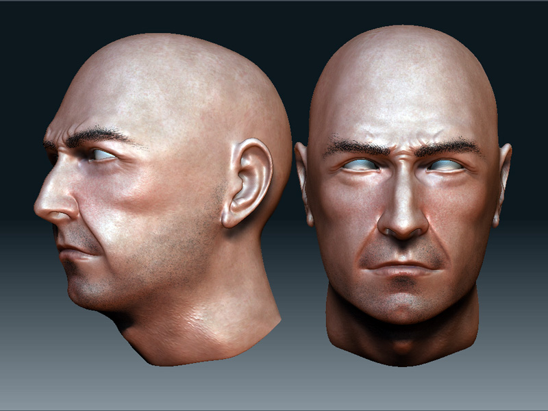

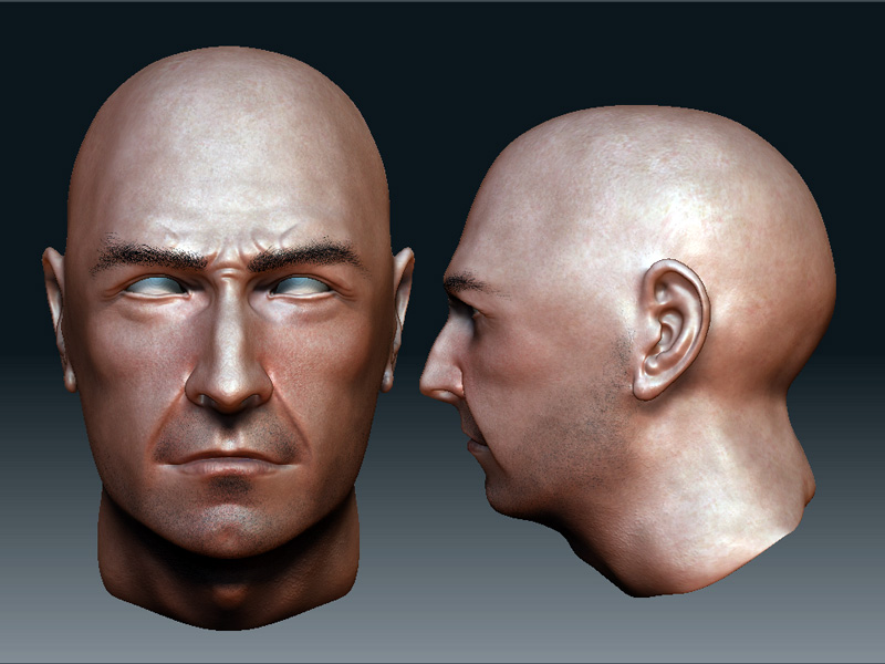

Here is a bunch of other angles.
Oops, sorry, it’s not exactly front/left/right, but the model is 99 per cent symetrical at this stage.

Looks pretty good. I am glad to see you fixed the back of the head.
Generally speaking, the proportions are OK. The ears are too high on the head though. As a general rule the top of the ear lines-up with the center line of the eye, and exends to somewhere between the tip of the nose and the mouth, depending on age etc… You should wiki the pinna (ear) anatomy for a good reference on the basic make-up of the ear. You are incorrect in a few places. The Concha (hollow at the opening to ear canal) and Crus of helix (the part that rounds-into the Concha from the helix (the outer cartilage of the ear)) need some tweeking.
Now, you may not care about this if you intend to cover the ear with hair, for instance, but it might be good form to get it right, especially if you intend to reuse the model.
The frown looks to have an extra fold that seems unnatural. I am referring to the outer-most crease. The angle of the fold does not seem to fit with the general mechanics of how they would be created from the tensing of the Corrugator on Frontalis muscles.
Minor crits really. it is coming on very well, and I am particularly impressed with the texturing.

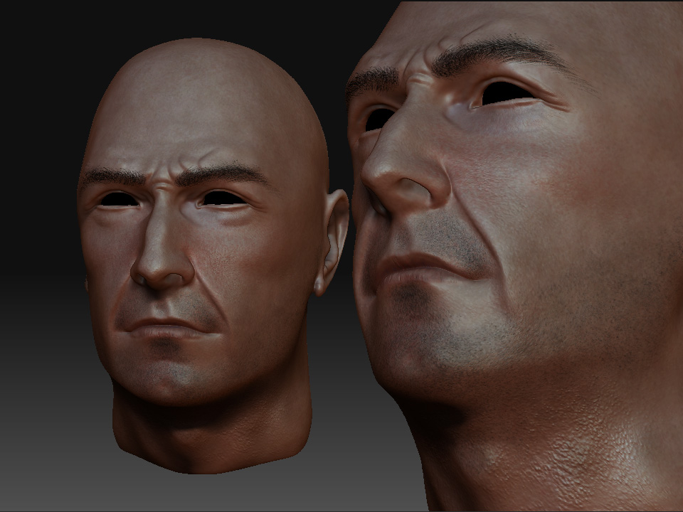

Thanks for your comment about the texturing. I’ve spent quite a lot of time on this. I stored the fine pore and wrinkle details in a separate layer and I find the ability to tweak the intensity fantastic. The colour was applied using a mixture of skin textures and standard brushes with colours picked from different areas of the texture map - just applying and superimposing layers for hours on end… Glad you like it.
(By the way, credits to Monsieur Legrain, whose wax skin material I’ve been using for these renders - It’s a very flattering mat for showing off skin textures).
EDIT: The brow was an experiment (black colour and displacement using a very fine brush at the highest subdivision level. I’m also deeply unhappy about it so any suggestion for nice, natural-looking brows that would not involve just projecting a photo would be highly welcome.)

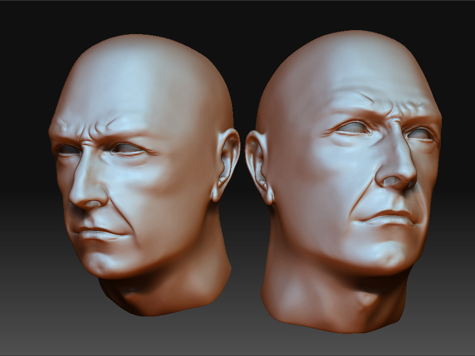

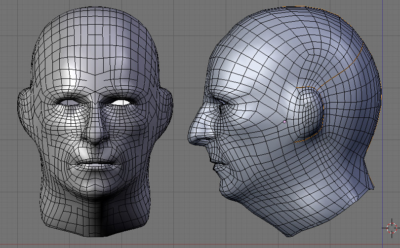

Here’s the base mesh, done in Blender using edgeloops.
It’s based on a photo ref, though not one that looks much like the character in the end. ManBaseMesh.jpg
Your base mesh looks to be over-detailed in places and not detailed enough in others. Please don’t think I am pulling it to peices… it’s just my observation, and someone else may dissagree.
The ear area has very little detail, in opposition to the eyes, nose and mouth, which have considerably more. What this may lead to is a higher polycount than you really need, because you may be subD-ing more to get the required details in the ear. What I am trying to say is there needs to be more balance. This can of course be rectified quite easily by bringing the ear detail up to the same level as the eyes on our base mesh. What I have found with ears (if you are building from a primitive) is that you need to create more edge loops, which is essentially providing you with the extrusion that you are looking for in the ear.
Here is a link to an experiment I took part in to build a base mesh in ZB from a cube using edgeloops. For the level of detail you have in the rest of the face I would expect something more like what I have (in the link) as far as ear detail (not that I am any Guru). Hope this helps. :slight_smile:
http://www.zbrushcentral.com/zbc/showthread.php?p=349197#post349197
Hi Elixir. I suspected that was the case. I noticed while sculpting that I was seeing huge differences in density in various parts of the mesh, and obviously not in the areas where I needed them.
This mesh is not as bad as previous ones, but I do find it one of the most difficult parts of the job. Trying to get reasonable densities in some areas and not in others without ending up creatings tris everywhere is a real puzzle. Your mesh looks very elegant in this respect. I’m going to save it and have a very good look at it.
There is nothing great about my mesh, but thanks for the compliment. It was, in truth, just the best I could do with just edge looping, which can be quite limiting. The way to go is retopology, but it tends to crash A LOT. I am in the middle of retopologizing a new base mesh which should put that one to shame. I actually learned a lot from this thread, which changed my outlook on edge loop and flow:
http://www.subdivisionmodeling.com/forums/showthread.php?t=907
You should take a look, if you are interested in creating a really good base mesh.
