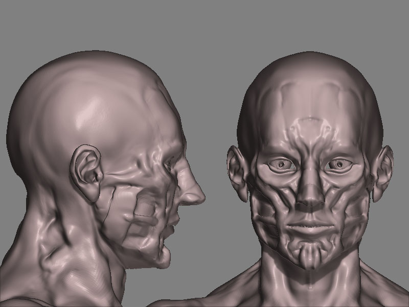

Some updates to the head using a masking technique to achieve sharper muscle edges. I have started to figure out how to use the deco brush. It seem like a horizontal striation texture could be used to create striations than can contour around the extremeties.

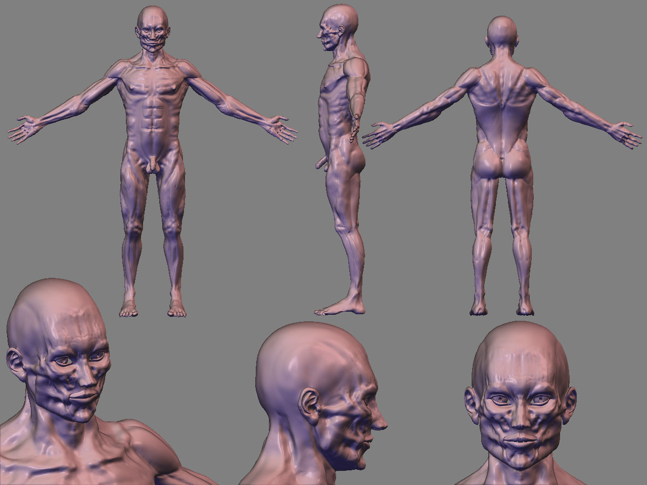

Getting there. Almost done forming all of the muscles. I am going to be gone for aweek for vacation. :smiley:

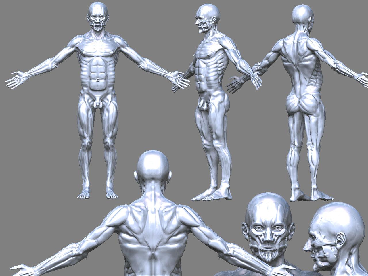

Is the bumps too much? I’m not going to render in zbrush for the final render since I want HDR lighting and area lights.
I think its a good update. I would say I think you should take the time to actully make all the striations rather than just using this bump. it looks like you just used noise or something.
I intend too. I’m just not sure what type of meat I need an image of for the bump map. The muscles do look like they are made out of meat and the striations kind of wiggle a bit. As for color I may have to use meat images as well. :slight_smile: What I really am not sure about is if I should model the surface veins. Some aren’t that easy to get references for and I’m not sure if they are arteries or veins.
The anatomy is looking pretty good there Womball. I personally think the bump is just a little too severe but I think the texture will make a big difference and once rendered it will likely be not so apparent.

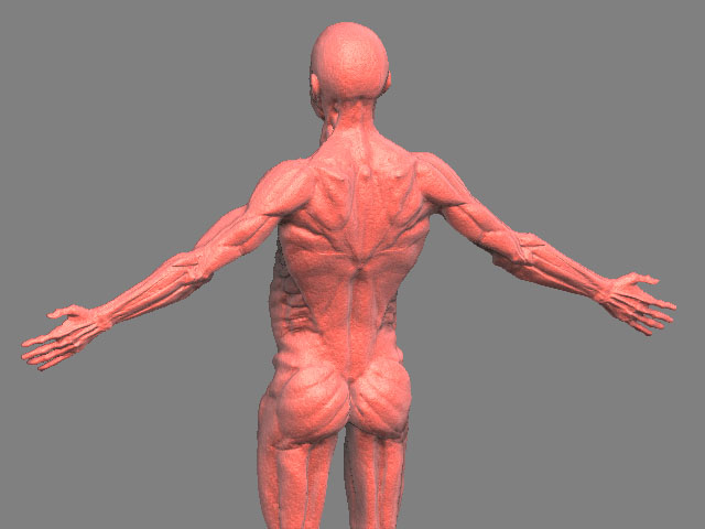

On the back view the scapula should be visible, especially in a pose like this. Check the connections of the rear deltoid to the top of the scapula as well.
On the front, the seperation between the Abs and the External Oblique seems to be a bit too deep. Could be the shader though.
Also, on a flayed figure I would expect to see more protrusions from the bone. They seem to be getting lost a bit too much, especially through the hips.
In general, if you want to REALLY push this I would begin to study the origins and insertions of each major muscle and whether the muscles lie beneath or over other muscles. There seems to be a feel of skin on this figure and I think youre going to have get some really hard edges to start seperating the muscles.

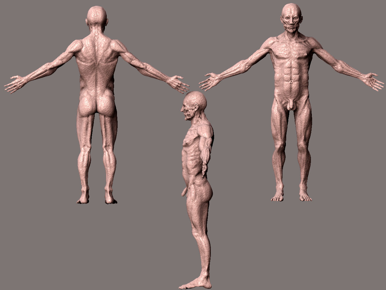

Preliminary color test, plus some more work on the muscles. They are really visiblie now generally. I use this cavity shader to bring out the muscles more. They are a bit less severe than this, but still severe. I will make the colors less uniform later, but I want to finish up the basic parts first. Like overall muscles attachments and basic coloring. And I want to do my striations. :confused:

Main thing is to get it to flow— if your goal is a flayed body then its pretty much a continuum, less lobulations to muscles-- at rest —
Remember everything is covered in thin fascia anyway. Think about a field-dressed deer…

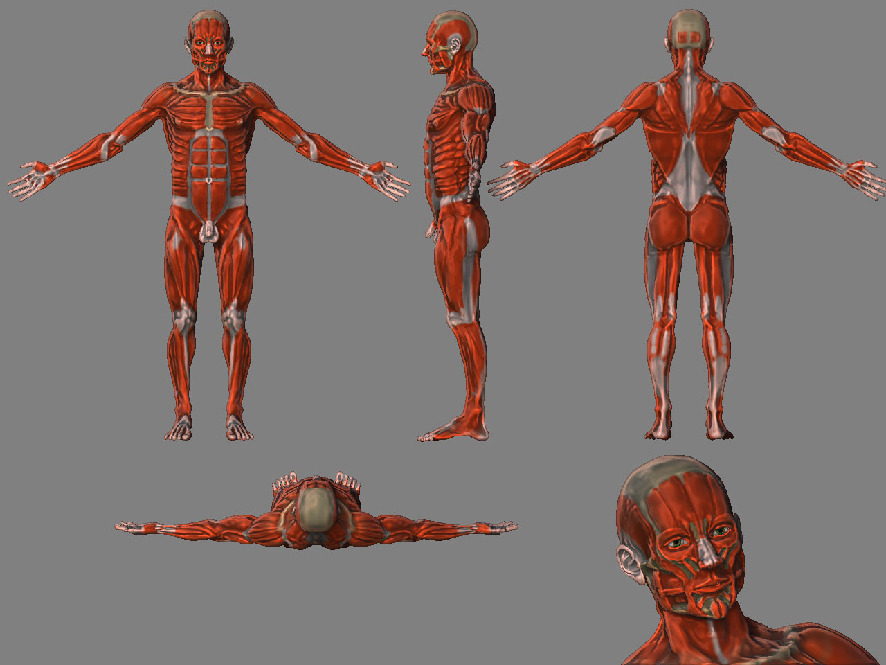

I reworked most of the suggestions that Art4Med gave me. Unfortunately I lost some work due to a zbrush crash, and my texture map was at the time disabled. When I retrieved the file I had lost my color map. :evil: I did take some pictures of steak today so that should help I think. I will see if I can collect tuna steak photos too. I’m going on vacation tomorrow for a week, so no updates for awhile. But I’m open to any paintover or suggestions. That pdf was pretty cool, very useful.

I have some high resolution images of red meat steak for the color map. It does’t have nice striations so maybe parts of tuna steak can be use for that. What color are tendons? Can white meat grilled chicken breast (slices) be accurate for the colors and textures? Would the bone be textured with lots of little holes in it or should be smooth like has a material directly over it, and than a wet map applied to the skull parts?
Also I’m still not sure about this quad muscle, does it underlay the mentalis of the chin?

There’s been a misunderstanding— when I mentioned tuna steak, it was only to encourage the experience an SSS= sub-surface scatter IRL.
Other than that, the steak on the scanner worked wonders in 1994, maybe over-the-top today… look at other muscle textures, incl some site-galleries of contribs in this thread and see how the muscles can flow together-- esp if one wishes to appear raw.
[If wanting to appear like a cadaver, then paint it all brown and dry it out (LOL!)]
As to the bone, it indeed has a texture to it, but only a few holes would do fine. Think “lightning-fused sand with pinholes.” The bigger holes would do if you run a bump map.
The quadratus is really just a portion of the platysma muscle to the corners of the mouth, you could ignore it if you liked— just like the risorius = much ado about nothing.
BTW, the mouth muscles converge at what’s called the modiolus, just lateral to the actual corner of the mouth… if you think about it, that makes sense in animation rigging… and the nasolabial fold goes thru it.
As far as a wet map (everything is wet)— remember to make the fascia on the top of the head (Galea) connect those frontalis and occipitalis m’s. Check out the procedure on the Samburu Warrior at http://www.zbrushcentral.com/zbc/showthread.php?t=036891
