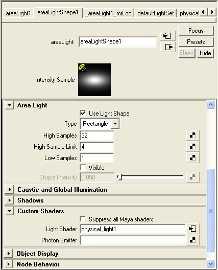

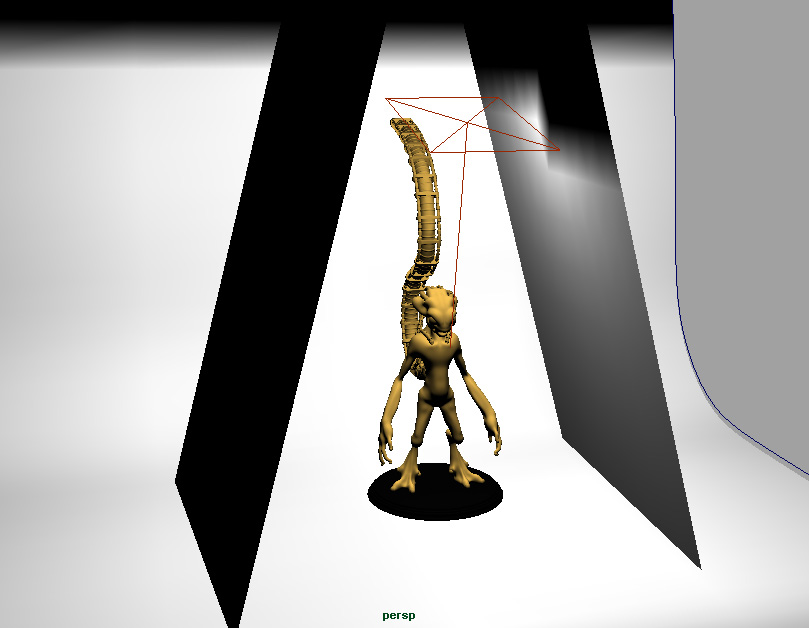

For the light, I tend to use the Mental Ray’s Area light shape, enabled to have a nice realistic shadow, with enough samples to avoid the grain.
Plugged into the light shader, a Physical light node, to give a realistic decay for the light.

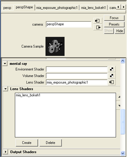

- Camera setup - - - - - - -
To avoid gamma issues with the displacement textures I use a mia_exposure_photographic for the main camera shader. For the dept of field i like the Bokeh lens, nice and quick.
[attach=185034]003 - Camera.jpg[/attach]

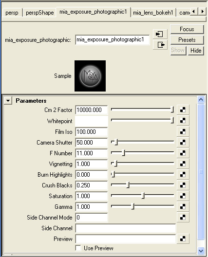

Using a 2.2 gamma in the mia_exposure_photographic node, the dark/lit transitions tend to look more natural. It also allows me to adjust the overall look of the lighting and contrast using the node settings.
[attach=185036]004 - Exposure.jpg[/attach]
In this pic the gamma is in a 1.00 value, the default is 2.2. and you should use it…

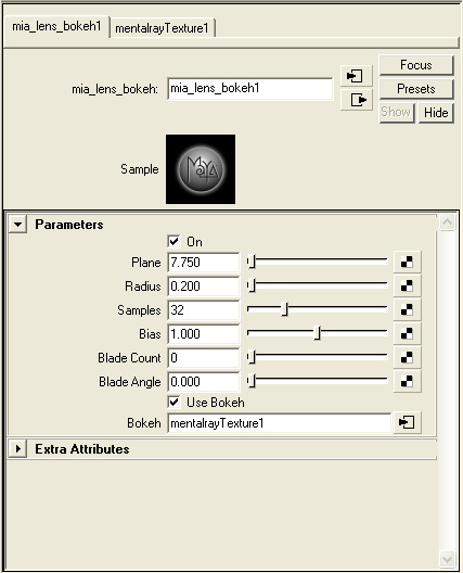

<table class=“fieldset” width=“100%” border=“0” cellpadding=“0” cellspacing=“1”><tbody><tr><td>[attach=185037]005 - Lens.jpg[/attach]</td><td align=“right”>
</td></tr></tbody></table>
For the bokeh node, the plane represents the focused point, the radius the size of this de-focus (in a real camera it is defined by the lens diaphragm). -
For the samples a good value for testing is 2 or 4, for the final render more than 32 is overkilling.
For the bokeh texture I use this image, tends to create pentagonal figures in hotspots (there are none in the final render). The color shifting on this pictures gives a pretty good sense of chromatic aberration.
[attach=185038]BOKEH.jpg[/attach]

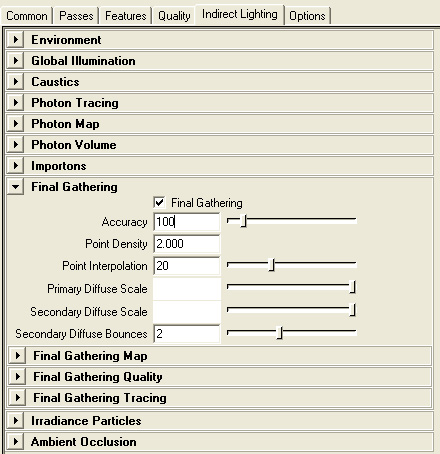

For the light bouncing I adore Mental Ray’s Final Gathering. The bouncing cards provide a good amount of bouncing light to define the shape of the model.
The light bounces in 2 gives a realistic lookl without extreme rendering time (I’ve seen some renders with 5 -physical correct- light bounces, but they tend to render for ages)
[attach=185039]006 - Light bounces.jpg[/attach]

IS there anything special your doing with the bounce cards material wise?

@ womball: The material of the bounce cards is a white and non-reflective material, just the same material of the curtain.

I’m getting some serious blow out with the area lights. What intensity are you using for the light. What are the physical light attributes your using?
womball - Adjust your blinn’s parameters to make them match this simple rule:
Diffusse + Reflectivity + Transparency = 100%
If you have a 0.8 diffuse (the blinn’s default) there is only room for 0.2 for reflectivity or transparency.
The blown out areas should be less noticeable with the lens shader aplied. Take on account that the area light’s size affects the quantity of light emmited from the light (duh :lol: that sound funny). I use physical light values over 10 thousand. This values change from scene to scene.
Thanks for sharing ISK-86! Great little tutorial. One quick question about the bokeh texture.
For the bokeh texture I see how the edges of the hexagon resemble chromatic aberration, but what exactly does this do? For EX: what if this was a circle instead? What would be the difference? Could you explain this particular attribute? Thanks again for the tutorial!
If the bokeh texture would be a circle, the bokeh effect would be a circle too…
