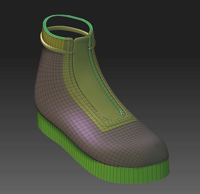

I’ve been all over YouTube looking for a way to make real eyelets and shoe laces tutorials. I don’t want them sculpted in, they need to be on their own subtools as I want the finished shoes/boots to have all their own material zones. Anyone help with this?? Shoe prototype below…
