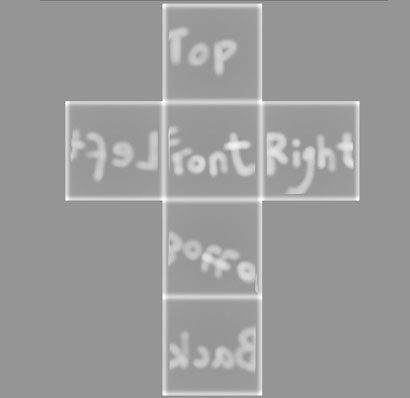

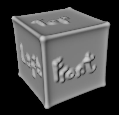

Normal maps seems no problem, but when I try to create a displacement map, things start to looks weird, you will see what I mean from the images below.

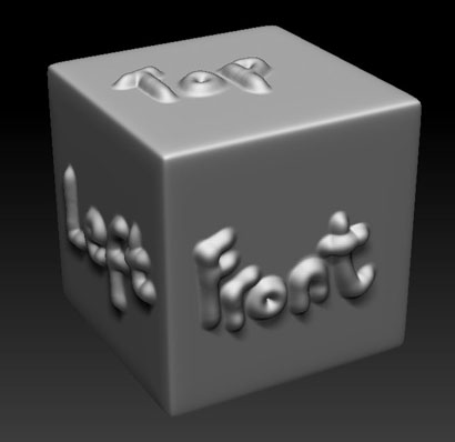

Here is the mesh inside of ZBrush…
I dont know which part that I’m wrong, but I guess the edges in the Lightwave render was “inflate” because of the edges in the map is white-ish in color, that’s why it result like that. Displacing the geometry on its normal direction like the one of the “front”, “left”, “top” words…
Anyone have any other thought that can explain this situation?

No this is happening in Zbrush 3.5. I am getting this even when using Maya mental ray, Vray or modo. The white that Zbrush is placing around the seams is incorrect for a 16bit result.
Anyways, you have to save a morph target and switch back to the MT before exporting the displacement map OR use “crease seams” by shift clicking it before exporting displacement maps. I think Zbrush needs to have this setup by default as it is probably used more often then not But Crease seams only seams to work for non-organic cube type setups because it makes the problem worse on organic models in a different way.

[Crease] seems won’t work on my cube either, after I switch back to the original MT and crease on all of my edges (by holding shift), it still give a weird edges (some kind of a black lines in the disp map) and some more it shrink the detail that I sculpt on.

I just browse through the forum and found the solution for this problem, thanks to Intuition and his threads here, now the mystery solved. Just turn of the Adaptive and Smooth UV (Adaptive will adding white edges to the map, Smooth UV will shrink the detail that sculpted on the mesh) and everything -hopefully- will be alright. :slight_smile:
