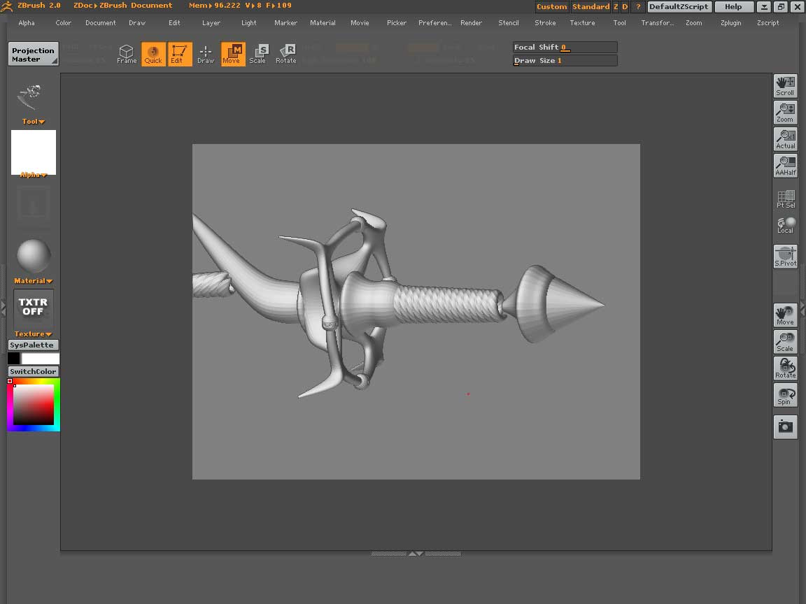

I am having difficulties completing the same tut I can’t seem to get the hilt to connect as show in the manual. see my screen shot
Also the tutorial does not state whether the XY symmetry is still active I assume it isn’t as the diagram only shows 1 orange square. And can someone please explain why I don’t see 2 copies of the hilt inserted as indicated in the manual.

Yes, the image is exactly the way mine turned out initially- I also could not see the two copies as stated. I did get the right result but I’m afraid I can’t offer much assistance as I fumbled my way through it (unlike the rest of the manual up to this point where every step was clear) and I haven’t had chance to redo it yet to clarify what I did
Here is the solution(figured it out like 10 sec ago :D). Create a Zsphere next to the big one and leave it alone, next create another Zsphere in between the Zspere in the middle and the one you just created, it will create 2 zspheres so delete the one that you didnt want to create. Then drag the one you just created into the large one(you can hold down shift so it will move in a straight line) then insert the hilt

thanks Heggiiman I tried your step and it worked I guess I will never find out what went wrong. It would be nice if the script could be posted.
