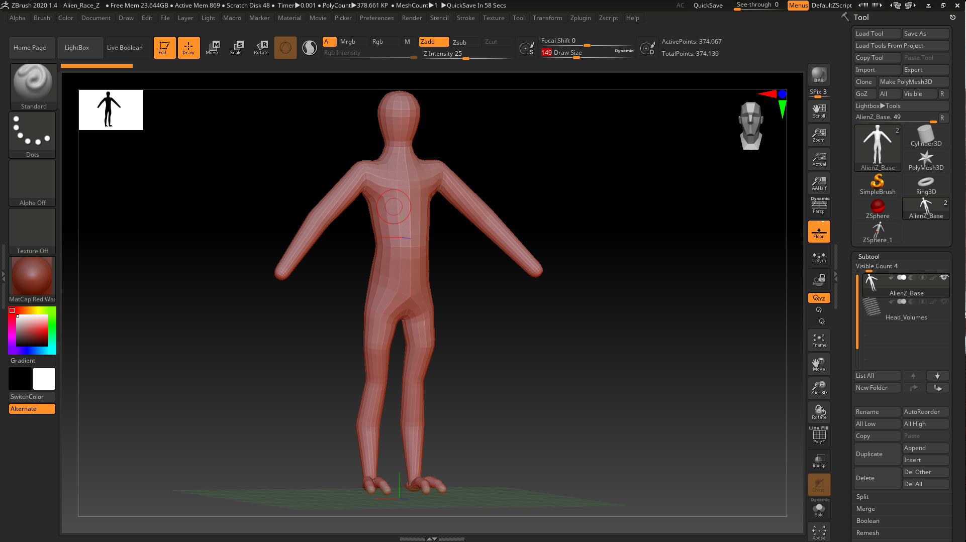

I don’t believe that is what is going on unfortunately. I’m trying to draw on a adaptive skin I’ve made of my mesh though all it’s allowing me to do is rotate it here’s a picture of what I’m looking at.
Thank you so much that fixed it!
