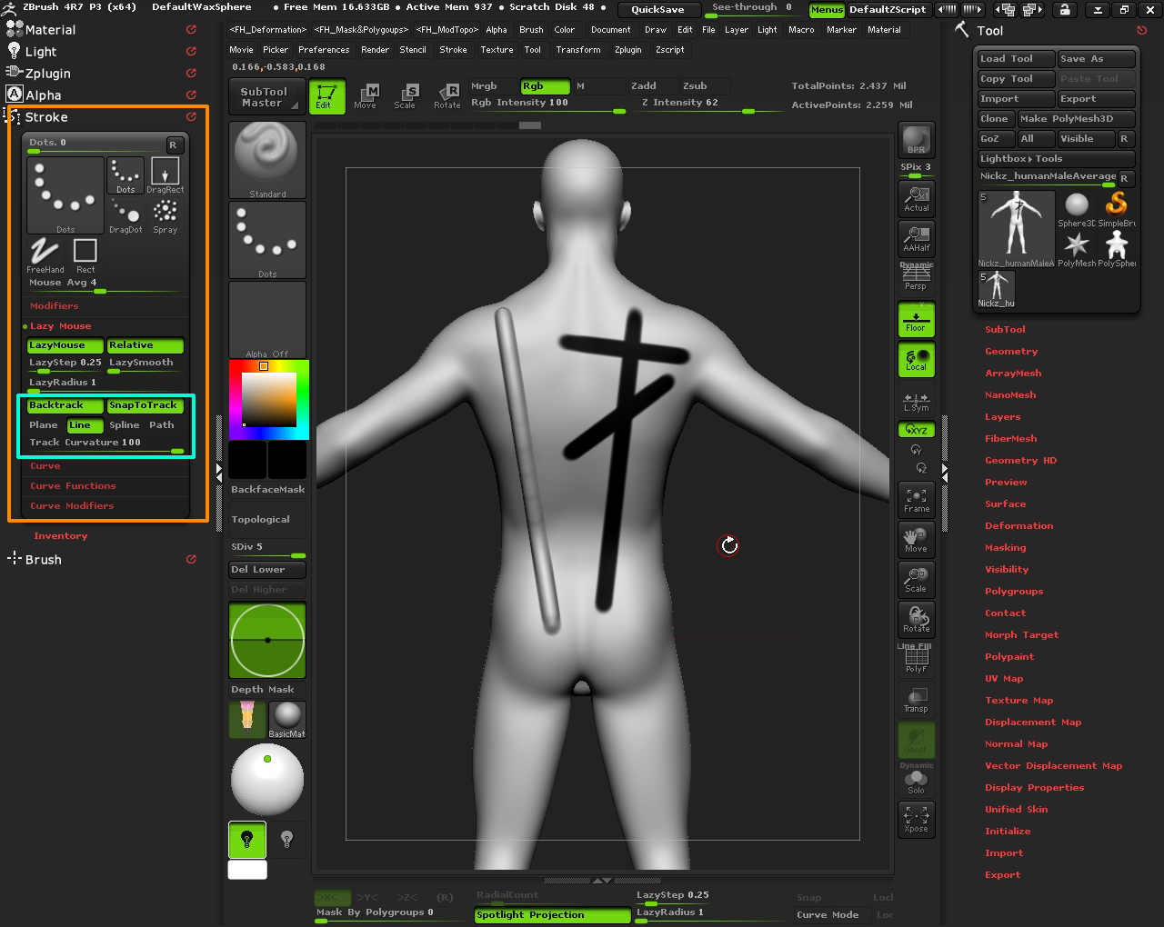

Is there a way of sculpting or drawing out straight lines in zbrush at any angle?
i know of the curve brush as well as holding the shift key these are limiting when trying to do straint lines in odd parts of your mesh.
many thanks for any help.
just to add. there is a similar function in photoshop where holding the shift key either snaps a straight line vertical etc or tapping at begninng and end points of your line so any angle can be straight. is this possible in zbrush?

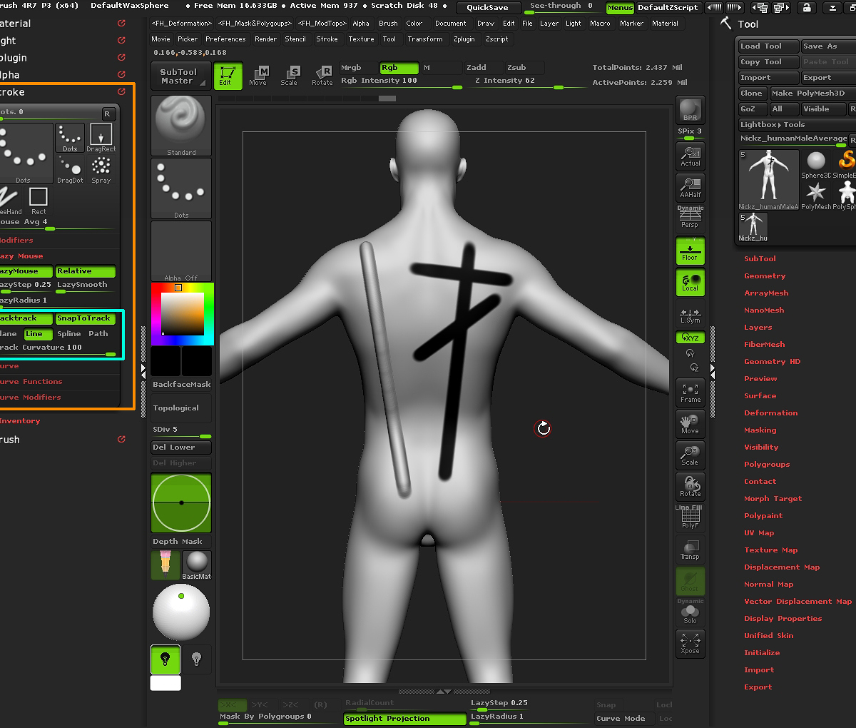

You have an option for backtrack while lazy mouse on that should fit your needs. Take a look to the image for the straight line settings
hope this helps
