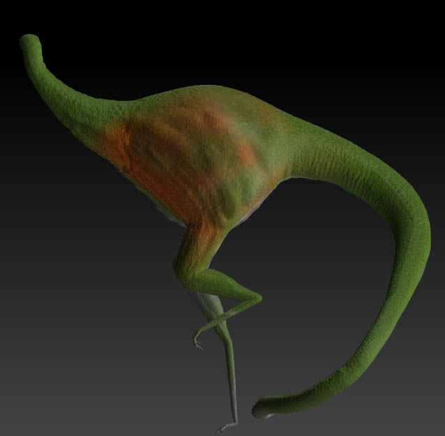

This model I made with Z Esphera, and has 5 branches, and also have not noticed, I can do small details. There is another way to solve this? Any tutorial?

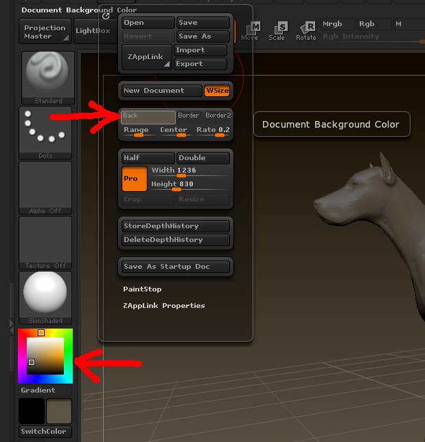

Now I have another question. How do I change the background color, I like the background color (black and gray). And how do I can do small details in the model or work. Sorry if the questions are obvious.
jaimedc,
To change the background color:
- Set the color you want in the color selector.
- Click the Back button in the Document palette.

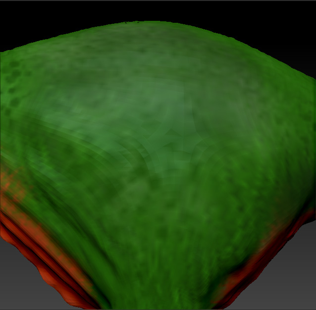

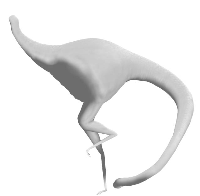

Here I leave a picture of how the model looks when I try to fine details and small. Because it looks pixelated and do not look good detail?
You need to subdivide your mesh more - there aren’t enough polygons to support the detail. Press Tool>Geometry>Divide.

My model was made with Z Spheres, Adaptive Skin (density 8) and has 5 subdivisions. I do not know what the problem
5 subdivisions means nothing. What matters is the number of polygons at the highest level. You will need at the very least 1 million polygons in order to support any detail at all, probably more. You can clearly see the polygons in your last image which means there aren’t enough!

I have looked at the screen shot you have posted and it looks to me that you do not have enough geometry (polygons)
I would suggest that you step up a few more subdivisions. you commented on the detail on my characters armour, that particular part had 7 subdivisions at around 4-6 million polys.
