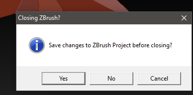

I can get the Close ‘x’ box to activate which brings up the save or not dialog box but I can’t hit the ‘n’ button to finish the process, from a ZScript:

The Delay doesn’t help. The key press doesn’t seem to happen, to not save, and thus finish quitting.

You need to use uppercase “N” and wrap the IKeyPress around the [IPress,Close]. You can use the ASCII code 78 instead of “N” but both work:
[IButton,Play,“Close ZBrush without saving project”,
[IConfig,4.8]
[IKeyPress,78,[IPress,Close]]
]/End of ZScript/
Also, if you are launching ZBrush from python with a zscript then you need to make sure the zscript will run automatically by wrapping the second level commands inside an [If,1,] statement (that is always true).

Not exactly. Lowercase “n” will not work.
