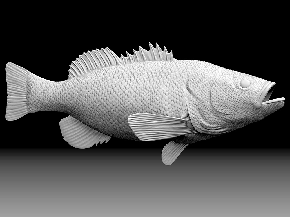

Also, you can read through this post where I helped someone w/ fish scales. I basically created one scale on a plane and then created my alpha from that, rather than a picture. Then you do all the scales on a layer so you can adjust the intensity, etc:
http://www.zbrushcentral.com/showthread.php?t=77079&highlight=fish+scales
Here’s an early render of the bass I made a while back. The final looks better, but I’m not at work. This technique gives a natural look because you drag on each scale individually, but the tilt brush is at least a thousand times more efficient.

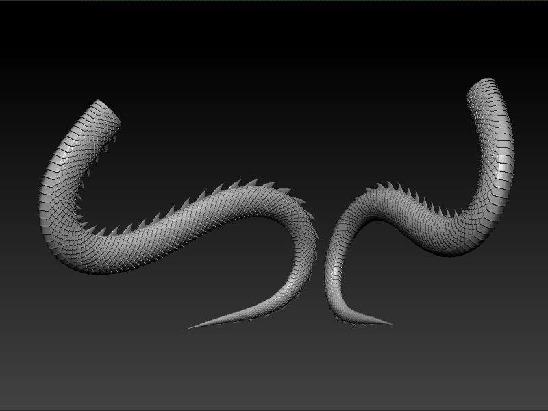

I made my own brush with Maya and Zbrush
Attached is my test brush
