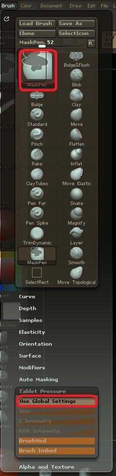

I’m guessing that you’re using a tablet. It sounds like what is happening is that the intensity of the mask is being controlled by the tablet pressure. You’ll need to adjust your settings in the Preferences>Tablet menu.
If you run into this often you can easily create macros for changing the settings to and from what you want for masking. Then you can even assign hotkeys to the macros so that you can make these changes with a single key press.

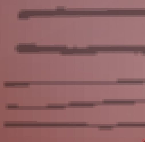

Just tried it again with my mouse. Let’s say I’m starting fresh, and bring in the 3d sphere tool, make it a polymesh, and divide it up to level 4. If my brush is wide (64 drawsize), most of the mark is 100% masked, but the intensity of the edges are feathered. The SharpenMask button won’t turn every pixol that is masked to 100% strength.
What I want to do is draw a thin line (small draw size) and have every pixol(polygon face?) that gets masked to be 100%.
Zbrush painting resolution on Ztools are depende on number of subdivisions.
So you have to divide your tool some more and try to paint thin line mask.
After draw the required line, press Ctrl and Alt (in windows, you use as per mac)
and click on any other place to narrow the smudging fron edges. U can use 2 or 3 times for very sharp edges.
