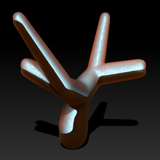

Couldn’t you just make a copy of the tree and make it “snow colored” and move it up slightly?
Hit “Duplicate” in the Subtool Pallet,
Select the new tree in the Sub
then in the Deformaition pallet set “Offset” to Y and try slowly moving it up, maybe by typing in the number field.
Also maybe (if that worked) try using “Inflate Balooon” to get that slight overhang snow would have.
Cheers!
Mealea
EDIT: I tried it out, very simple and under a minuet to make:
