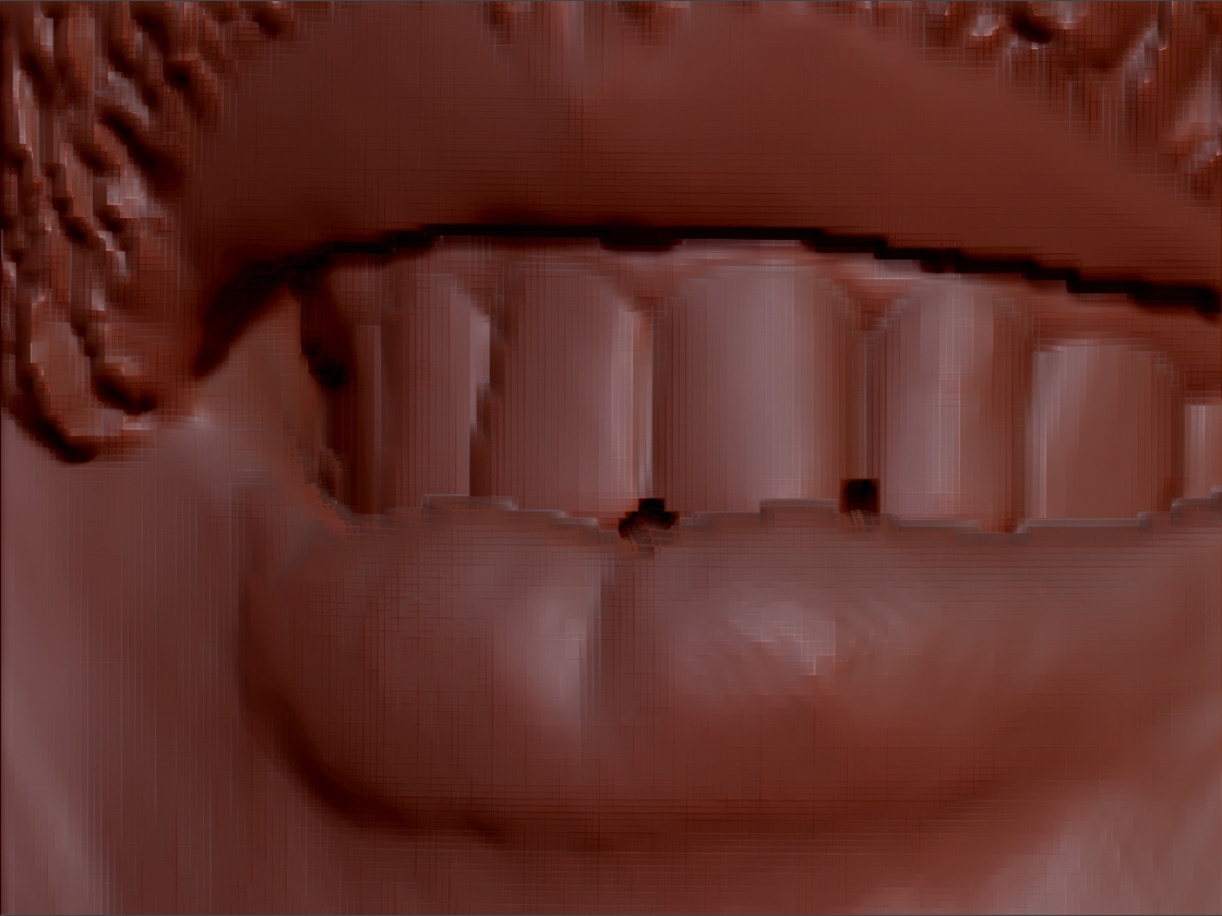

How to close or smooth deep holes in zbrush in few steps?
http://docs.pixologic.com/?s=Close+holes
Please help me with a specific solution to this problem…I am a beginner in zbrush ! Smooth brush does not help nor the inflate brush. I do not want to dynamesh or zremesh to solve this simple but tricky problem.
This will close all holes:
tools-geometry-modify geometry - close holes
Other option is use the zmodeller brush, edge actions, hole. This only will close the selected holes.
If the hole is not open but simply a deep geometry you could delete the unwanted polys first and then use the tools above.
Close holes will only work if there are holes in the geometry (ie it is not watertight). this looks more like deep gouges in the geometry which means three is probably no hole. I would isolate that part, change the visibility to ‘double’ and see what it looks like from the inside. Might be able to mask those bits and push them back out a bit.
Hi Altea, Thanks. the first option did not help. The second one seems promising.
Yes Gordon Robb , it is not a hole indeed. A deep pit. Shall try to mask and push …ty for the help
